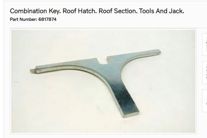

Old Mar 31, 2023 | 10:57 AM
Here's instructions and what the tools look like. Can't tell if that's an allen or a torx - the triangle tool is used like a screwdriver - turn to put the electric gearbox in "neutral" to allow the allen/torx to be turned.
