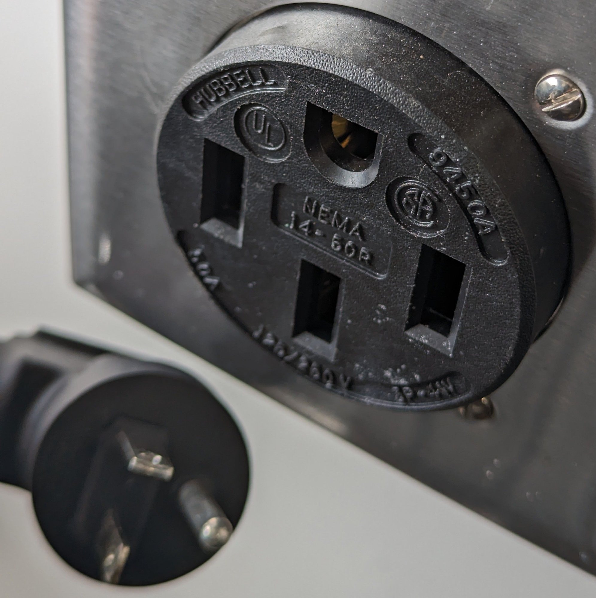

I set up my garage for my son's Tesla with a 240V/60A NEMA 14-50 receptacle. I now have a 2024 XC60 Recharge that I would like to charge. Is there an adapter that will convert the standard Volvo cable plug to a 14-50 receptacle? I've been searching, but no joy.

PHEV's and EV's in general are new to me, so I was looking for some advice from the forum gurus on a more efficient way to charge my XC60 using the Hubbell NEMA 14-50 receptacle I already had in my garage. Nonetheless, I finally found the adapter I needed and I am now charging with 240V/20A: "AC Works Adapter Cord w/20A Breaker P/N S1450CB620." $61.99

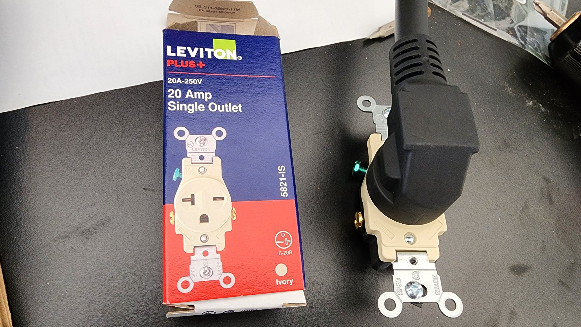

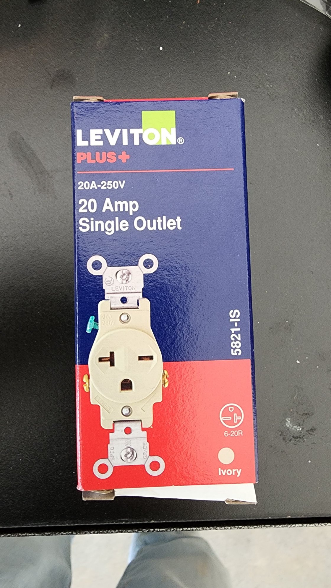

Default Level II charging w/supplied Volvo 240 cord
For all of you that already have a 240v Nema 1450 receptacle in your garage, this can save you a lot of money in getting set-up to use your Volvo supplied Level II cord. I found this at my local Ace Hardware yesterday for less than $10. Just flip your breaker off 1st, then remove the Nema receptacle from the wall, and connect the wires to this one and replace it. Easy day installation w/o calling an electrician.
Hope it works for you.
What you want at Ace Hardware
What you want to remove and change

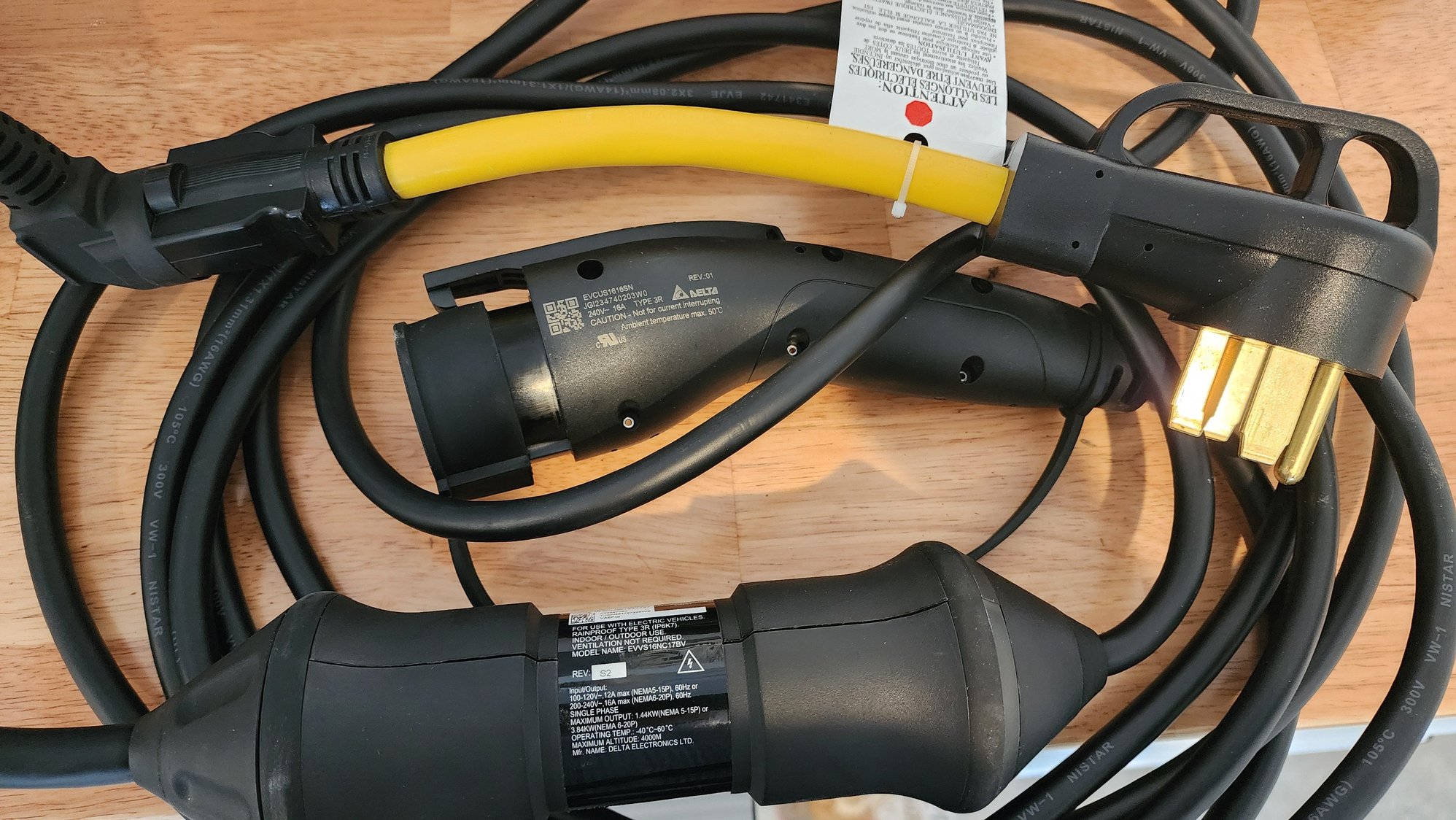

In addition to my other post, I found and ordered this one. It works great, see photos. I found it on Amazon for $20.99 including shipping. Works very well.
