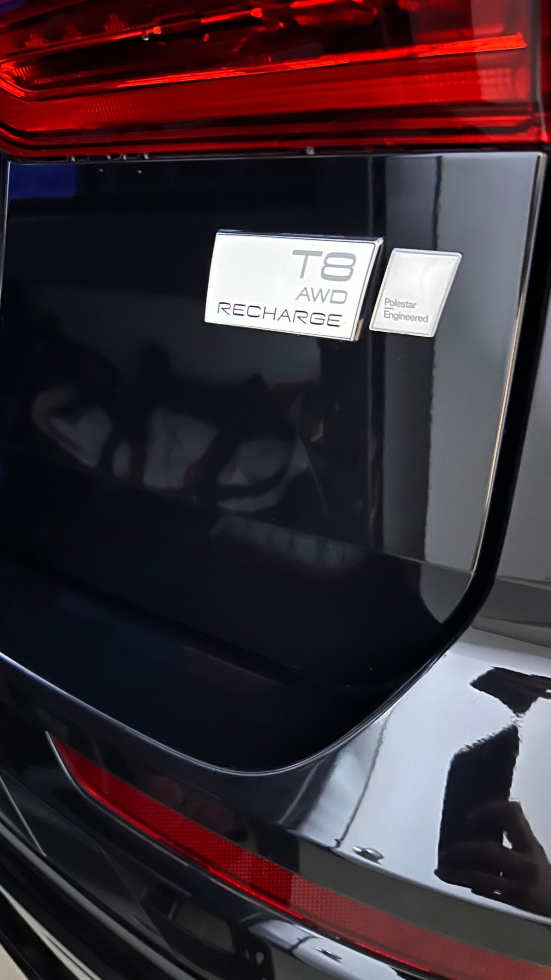

Volvo XC 60 T8 Recharge Onyx Black
Polestar Optimised

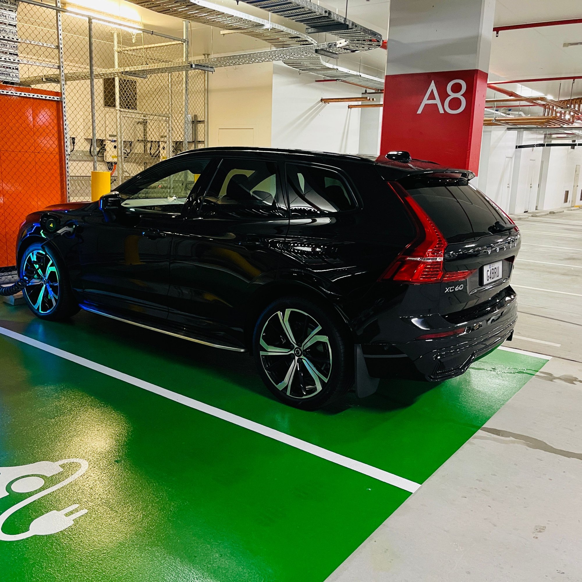

Sweet! I just got the exact same color and wheels (minus the polestar). Great choice! Do you love it? What does the polestar actually add?
