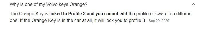

Just bought a 2021 s60 recharge plugin t8 inscription. I am trying to setup our drivers profile with key. When I start car it shows profile 3 care key. When I go into profiles it shows profile three clicked on but nothing is highlighted to add or edit. The confirm option is also not highlighted. What next?

Take the orange care key out of the car and use another - you can change the profile on it. Haven't read how to change an orange key - but you can't do it if it's the active profile.

Yes. You only have One Key(remote)? Should have been at least two - three came with my 2020. Two masters (black keys) and a red (limited) key is what I have. The "Red" key was changed to orange the next year.
The orange key is not a "master" key. Search volvo owners manuals to figure out what the orange key is. Unfortunately a new master key is many hundreds of dollars. Volvo MIGHT be able to "upgrade" (with a software download) your orange key to become a master key.
