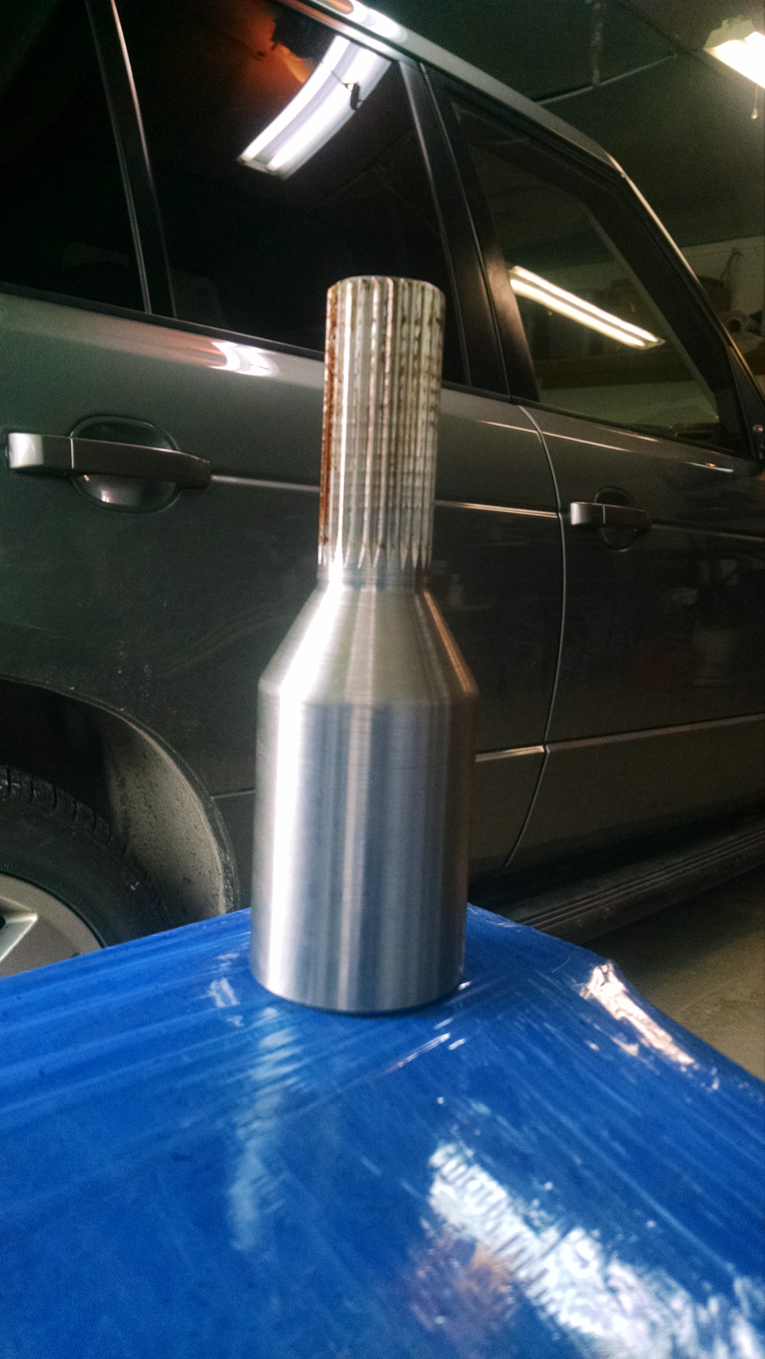

Had it drained down,out and on a stand in @3hrs. Thing is with them, the whole intake has to come off before pulling it, as under that is where you secure the lifting brackets!
Takes a little longer due to it being a far from stock install too. I made adapter plates to reuse the Range Rover AC and Power steering pumps, same for the alternator.
Here is the only known LSx engine in a Range Rover of this model, in the world....Only took me a couple of years, working on it from time to time between work. And some various adapters I had to make. The adapter shaft I had made though, small machine shop in WV, after the 6 liter shredded the one I made here.
