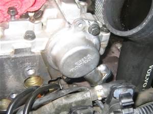

Default Trying to install camshaft position sensor
Trying to install a camshaft position sensor. Can someone help me with where it is, and how to get to it? Looks like it should be easy to install
Old Dec 16, 2015 | 05:35 PM
  #64
Leftlanetruckin's Avatar
Joined: Dec 2015
Posts: 144
From: Mid Mo.
Its on the right side of the motor as you look at it with the hood open.
There is the CAC pipe (aluminum tube) and an engine lifting eye.
Right behind that lifting eye, towards the windshield, you will see the back end of the exhaust camshaft. There is an aluminum cover over it with 2 10mm bolt heads that bolt it to the head. Undo those bolts and the cam sensor is in the housing.
You will have to undo the wiring harness that is connected to the motor mount, 14mm I think, and move it out of the way to access the lower bolt for the rear housing.
Martin

Thank you Martin. And this is where it is on a 02 S40?
Old Dec 16, 2015 | 06:57 PM
  #66
Joined: Dec 2015
Posts: 144
From: Mid Mo.
Correct. That is the exact year I've been wrenching on lately. Got it for $750 a week or so ago, for my eldest kids girlfriend. Been working on it ever since.....lol
I can take a picture of the location if you want, but if you look at where I described, you will see the cover.
Martin

A picture would be awesome!

Dark here now, but will try to remember tomorrow mate.
Let me see if I can find the relevant piece on Alldata and post it for you.

Old Dec 16, 2015 | 09:03 PM
  #69
Joined: Dec 2015
Posts: 144
From: Mid Mo.
From Hudini.
The pipe on the upper right is the CAC pipe, that goes to the aluminum pipe that runs on the top of the motor, to the bottom of the turbo intercooler.
