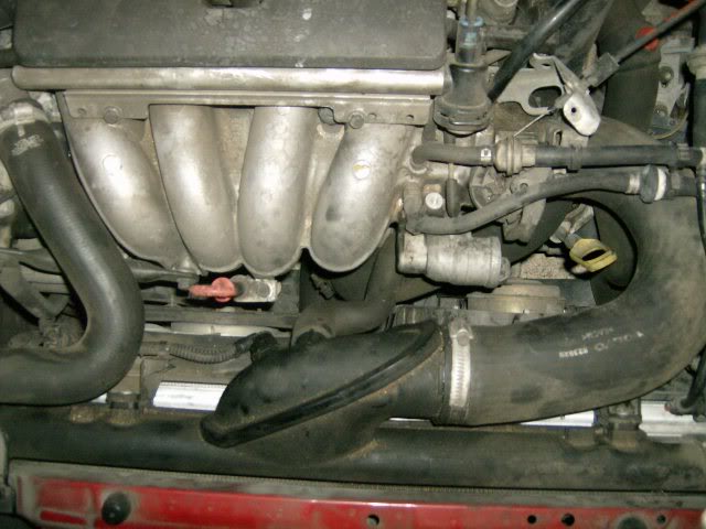

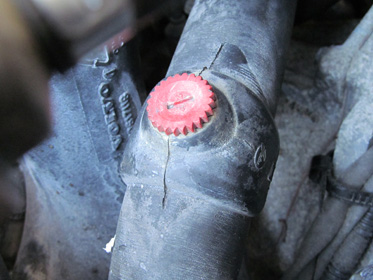

Try using this bleed screw. See if any air is tapped. When mine gave me cold air it was just low on fluid.

It in the top right of this photo to give you an idea of location:
