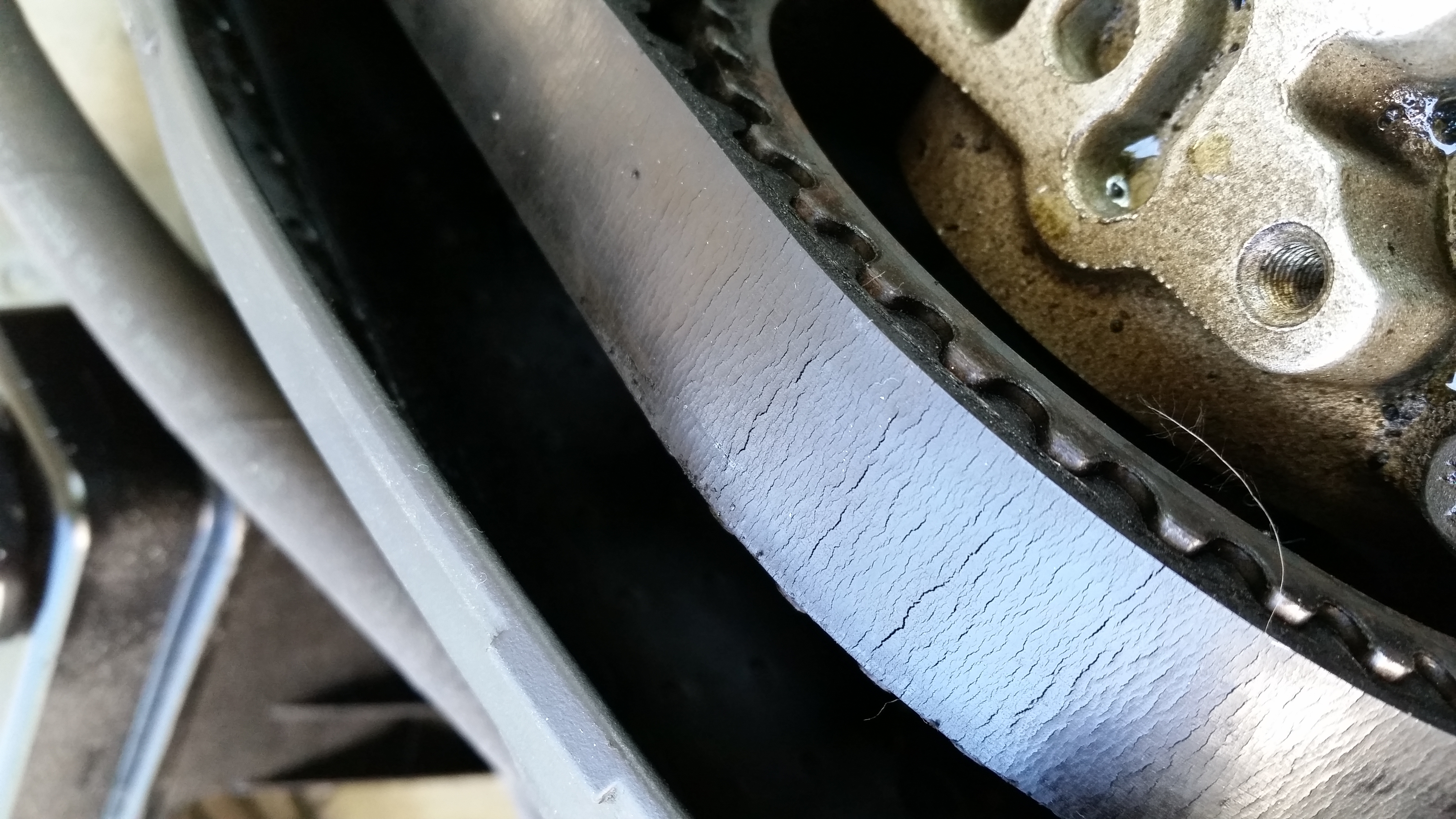

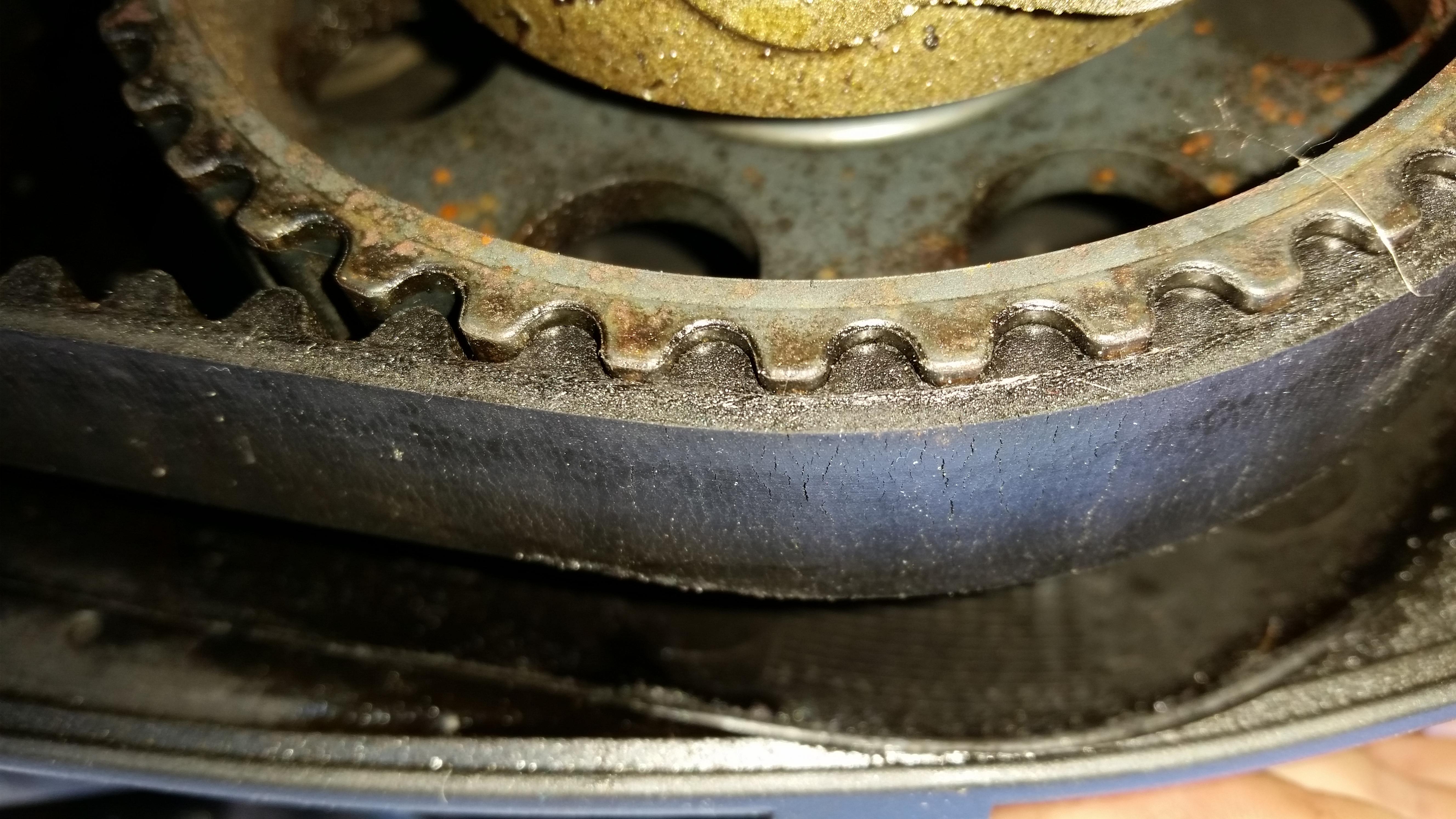

I was looking at my timing belt does it look in need of replacement?
Old Jul 16, 2015 | 07:56 PM
Likes: 541
Do you have any idea of when the belt was last replaced? a good general rule is 7 years or 70K miles (whichever comes first). A second rule is if you don't know and it doesn't show signs of any recent work, replace it! Investing a few $100 now lets you forget about any problems for a while and its insurance against a failed belt which translates to a valve job in the $1500-2000 range (S40s are "interference engines" meaning the piston motion overlaps in space with the valves - so any mis-timing from a belt failure and you slap the pistons into the valves.

No idea, got it used 161K miles on the car. I am going to replace it next month when I have more money just hoping the belt won't break till then.

From those pics I think you definately need to attend to the cam belt etc asap.
The cracks are clearly visible.
I would not be working the engine hard at all prior to you getting onto replacing.
