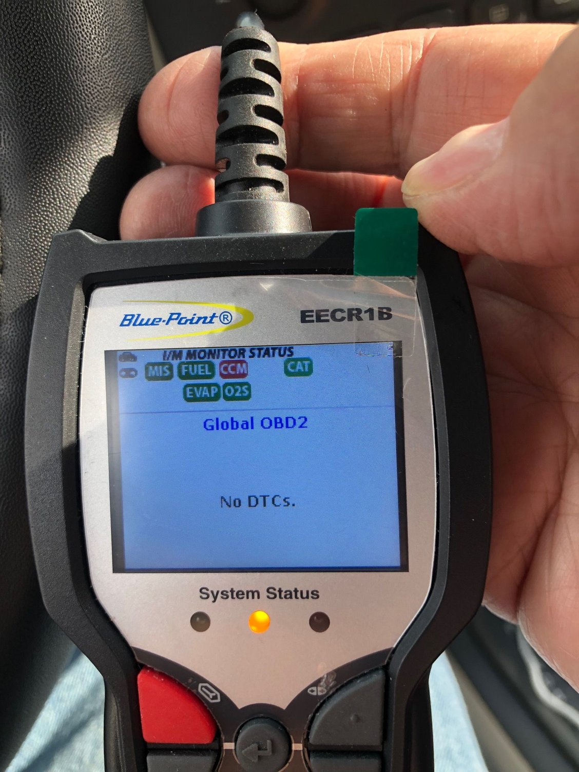

Hi again I am still struggling with this S40 Here is a picture of the reason I cannot pass NJ inspection..... this is a 2001 and Volvo said just to look at it , it will cost minimum of $600.
Damm Please any help would be greatly appreciated I say it is Climate control Module.
the inspection says Comprehensive control module. HELP>>>>>>....................................... I put a different climate control module used in still the error. and there are no DTC codes as you can see.

Nothing in the The Climate control module should have anything to do with emissions. So CCM - does not mean climate control. Once again - there are no codes shown on your screen. You are looking at the status monitor screen. Get your scan tool owners manual and figure out what button to push to retrieve the codes. Or go borrow a code reader at your local auto parts store.
Then post the codes because nobody will have a clue what code you are trying to fix - until you have a code!

let me say this again I have no DTC codes and I have done the Volvo drive cycles more that 20 times and a 8 components are green except for the CCM which is still red and flashing.. Today I believe I found out that it is the Traction Control Light is on ( possibly the issue ), and this maybe the issue I am having with the comprehensive control monitor in the car and it will not pass inspection with this CCM flashing red all others are green . Here is the picture of the reader. I need to get the CCM to turn Green as to pass NJ inspection...... I hope I made this clear and am correct in what I am thinking. Again there are not codes in the system. this reader cheches all the 8 components to see if they are ready to get the car NJ inspection.
