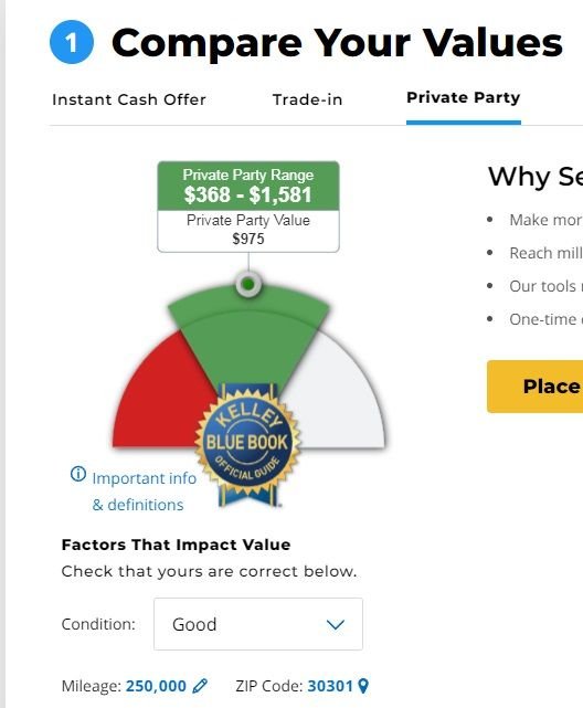

How many miles on the car? Average 12k a year X 20 years = 240,000 miles - certainly the convertor may not work as well as it did when new. And to be honest you might want to be careful how much you spend on your $1000 car.
