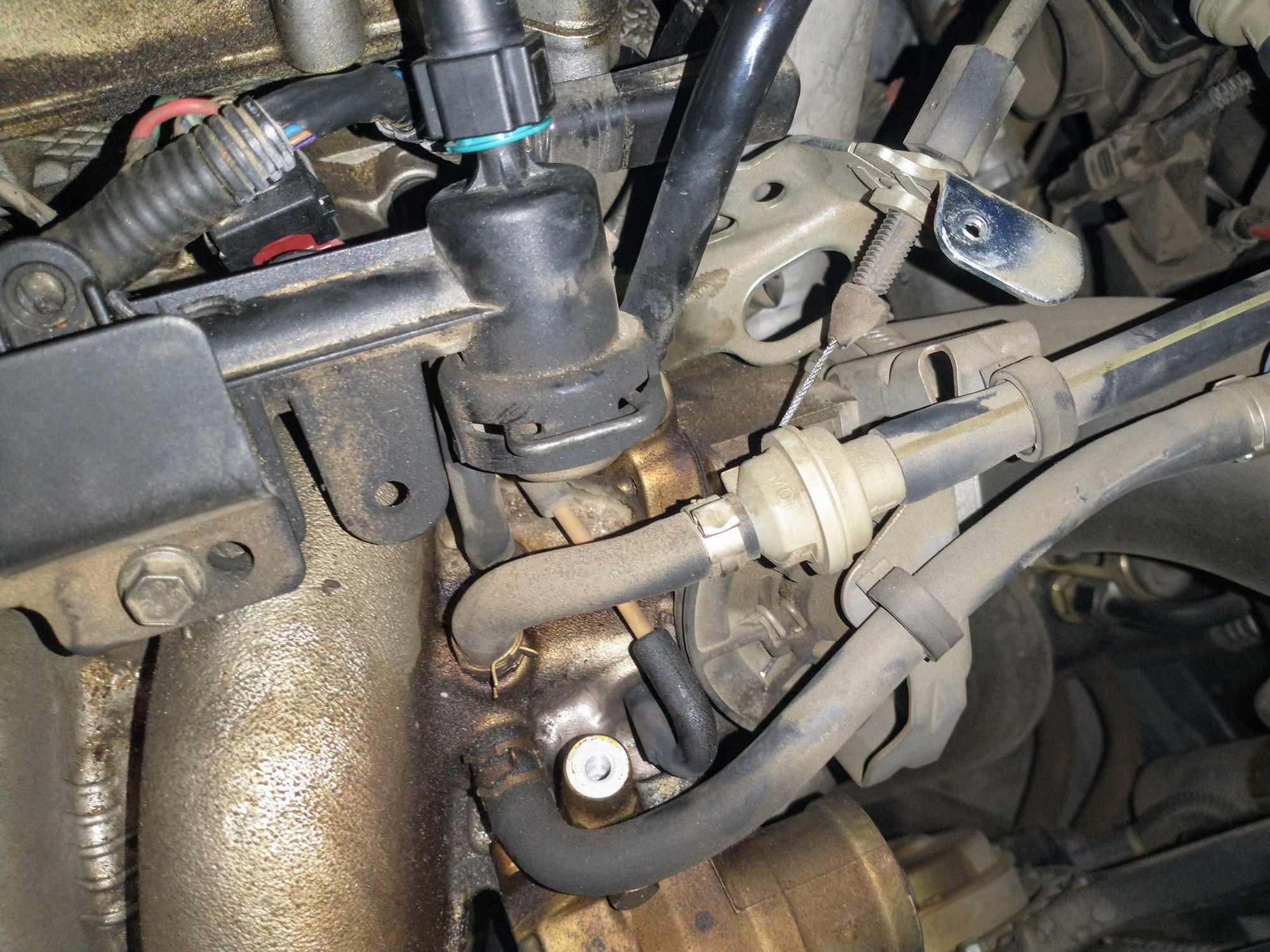

4. Leaking Fuel Pressure Regulator (FPR) and torn vacuum hose. Haven't replaced, fuel coming out of hole in vacuum line.

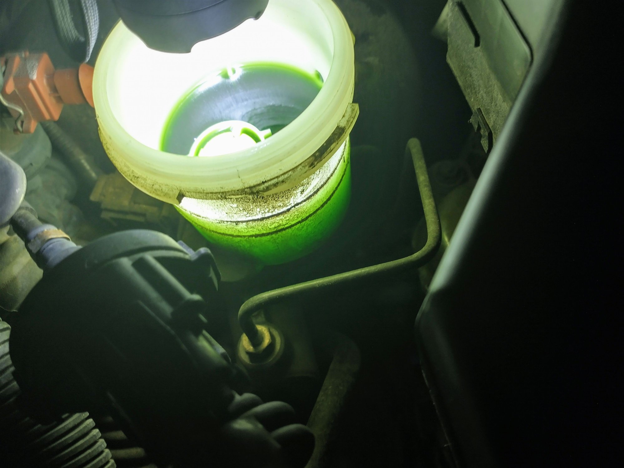

5. *Green* (Yes, green) brake fluid. Copper contamination? Green dye? Tech filled with coolant? Don't honestly know, but want to flush and bleed with fresh DOT-4. Brakes are mushy, but not quite bad enough for me to think it's the master cylinder.

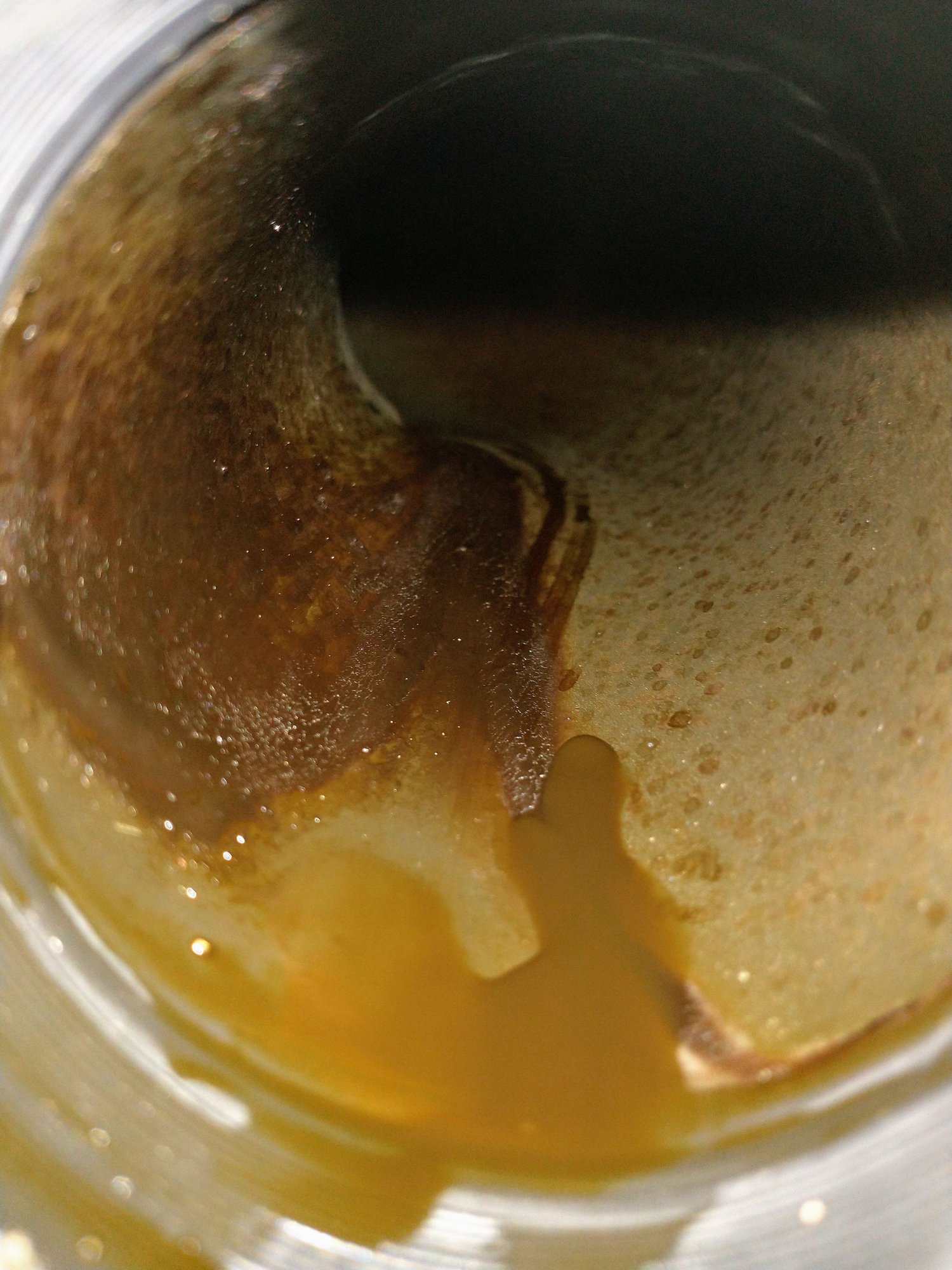

11. Cracked oil cap gasket and dirty oil cap. PCV, heat, and age, I'd assume. Smell gas in the oil fill. PCV, I assume.

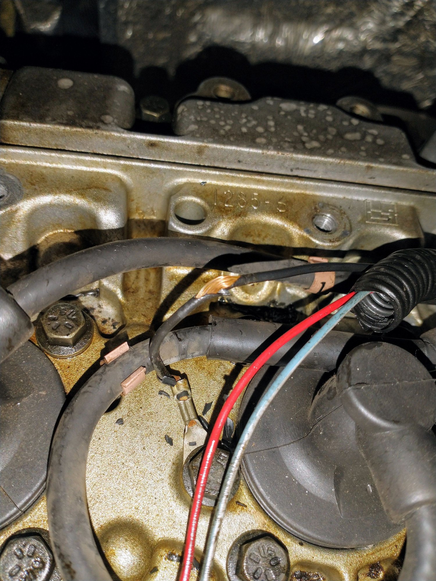

13. Split insulation and exposed wire on ignition coil wiring. Also, oil made it through the gasket on the plug for the wires next to the timing belt. Cleaned out the connector, but the gasket was destroyed.

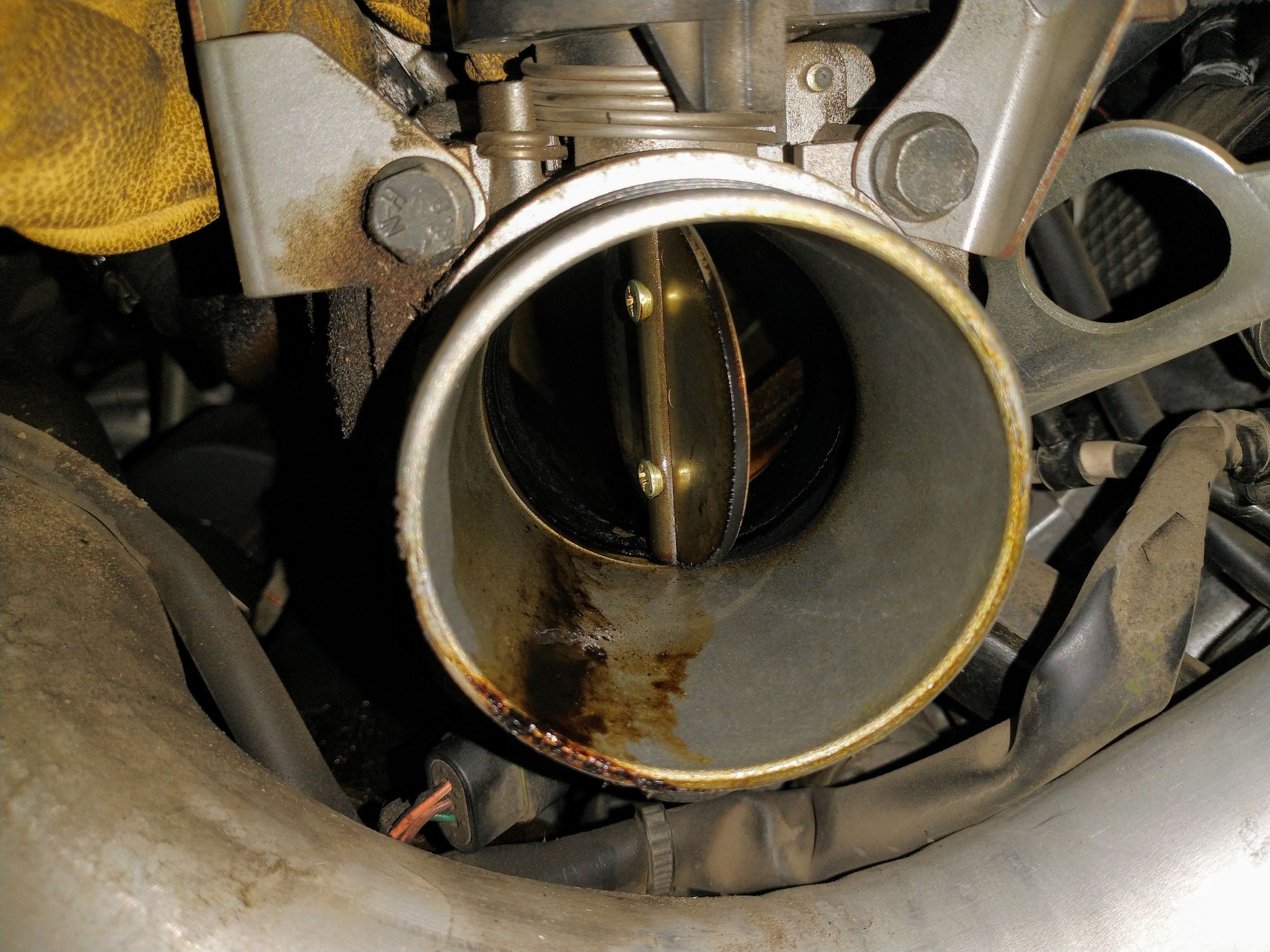

19. Dirty throttle body. Gee, wonder why.

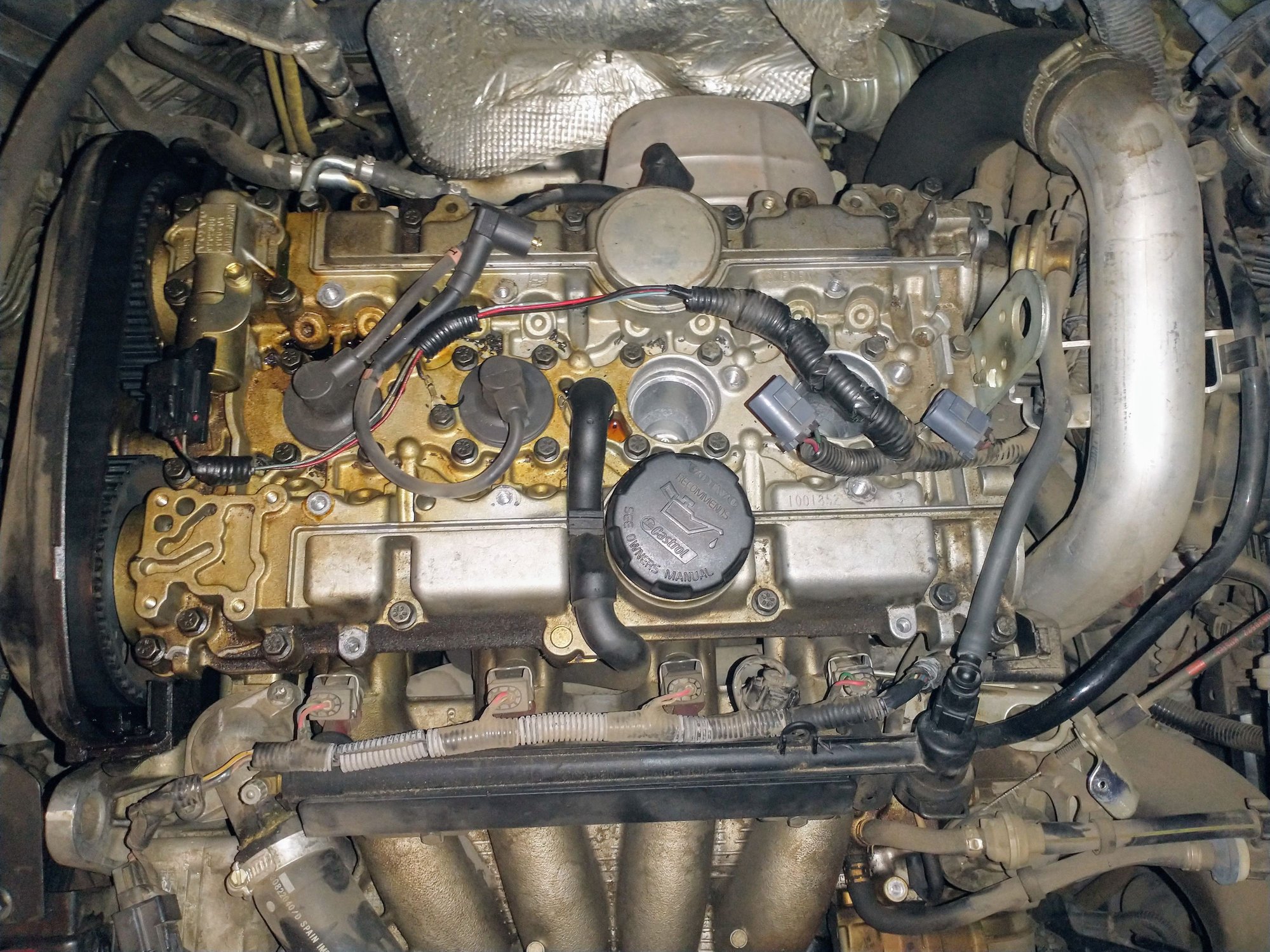

Top of engine with covers removed. Ignition Coils out for testing.

Fuel rail, FPR & vacuum line, quick-disconnect.

Dirty oil fill.

GREEN?!
Exposed wire.

Throttle body closed.
Throttle body open.
