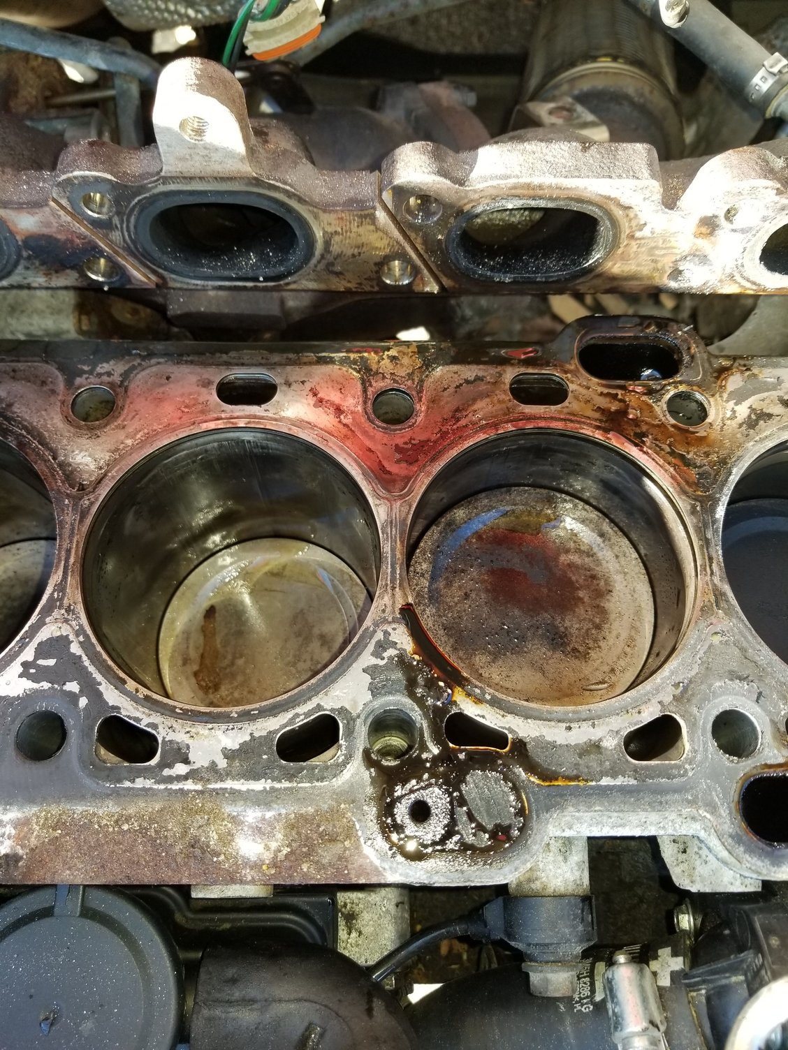

Thank you for the pics....I have torn the engine down to the block. I just feel safer since I have gone that far, I found signs that the head gasket was gone from a overheating issue prior to me.

Yeah, I'd say that the car had a head gasket issue... yikes. You might want to have those scratches in the left (in the photo) cylinder looked at by someone to see if they're deep enough to require a rebore.

The scores are cosmetic if there is such a thing. there is no feeling to them, smooth, I am going to push out the pistons and hone out the cylinders. Install new rings and bearings.

I like the way you think! That's what I'd do if it was mine.
And glad to hear that you can't feel those scratches. They look like they COULD be deeper than that, but I have no problem believing that a hone will take them out, either.
