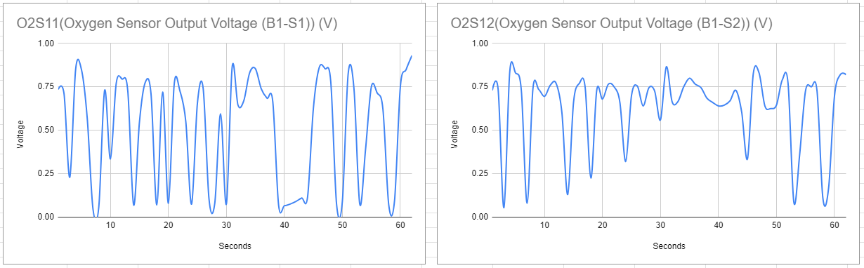

No engine codes showing up at all, and I noticed that clouds of white smoke comes from the exhaust whenever I pull away from a stop when the engine is in operating temp and the rattle occurs (Not even hard acceleration).
I did a live data view on both the oxygen sensors before and after the cat, and the second sensor's voltage fluctuates quite drastically (which is apparently not good and a sign of a bad cat)
