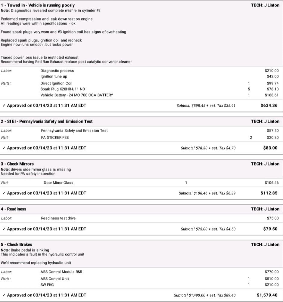

Thanks. From what I understand, passing the compression and leak down test indicate something other than having a head gasket problem. I certainly hope I found the right mechanic to get and keep the vehicle running safely again. If it were a head gasket, I understand from the mechanic that rebuilding it would be the better solution than finding another used engine.
See photo of previous non-Volvo mechanic's estimate for a used motor.

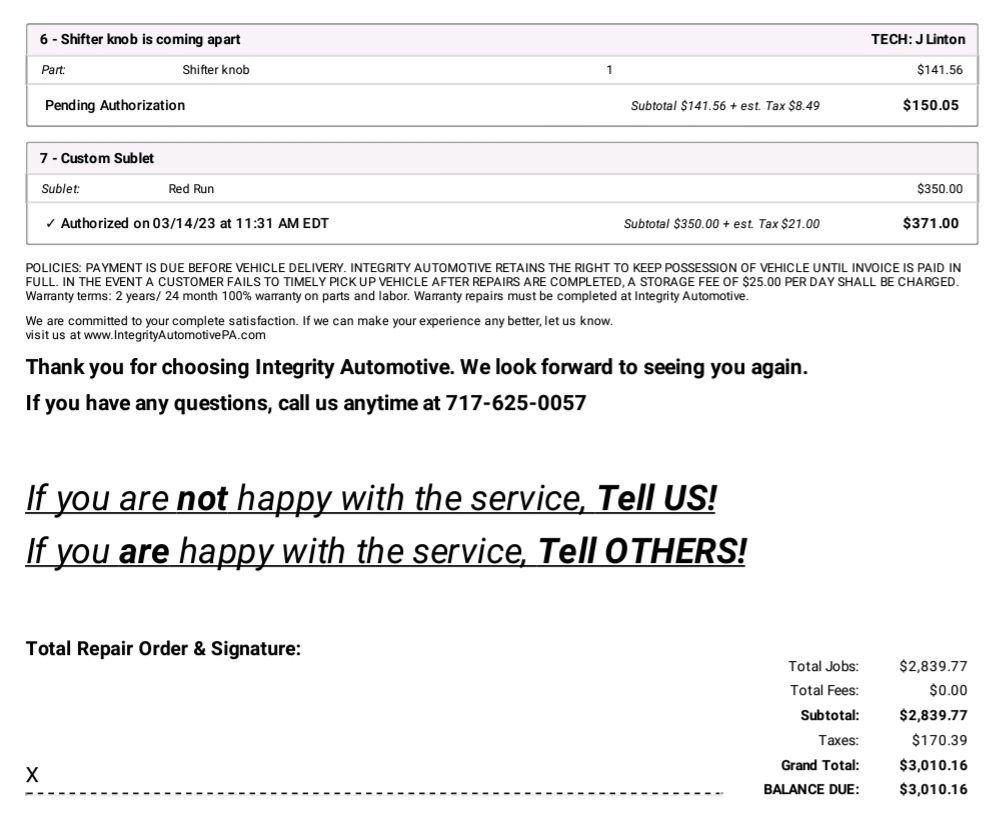

After speaking with the mechanic, the repairs have all been made and the only thing they are waiting for is the $1200 work required to fix a brake pedal that creeps/sinks too far down when pressed.
As for the main issue with the engine:
a. installed new catalytic converter other than the Volvo more expensive unit
b. replaced spark plugs
c. replaced spark plug coil (#3 spark plug coil had previously been replaced years ago after codes kept reading a misfire for #3 spark plug)
d. leak down and compression test within acceptable range (140 - 150 for compression test)
e. replaced passenger-side mirror that had been fluttering after the glue failed to hold it in place)
Total cost including taxes: $3072.00. (includes the new hydraulic seal and software upload for braking system)
