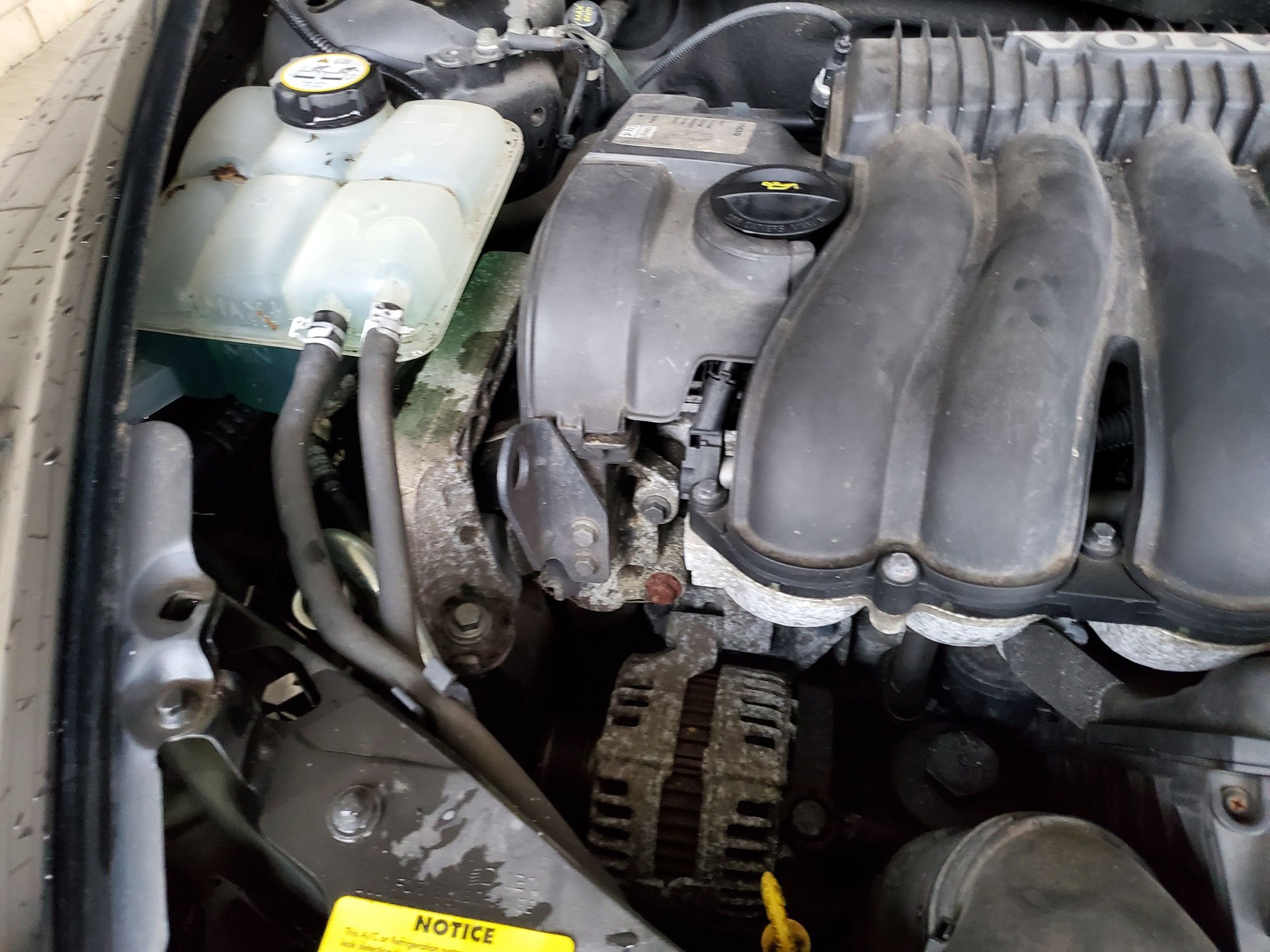

Well I assume its a 2,4 volvo S40 non turbo , not sure what you have spent so far on an old car , but looking at the state of the alternator , must have a fair bit corrosion on many parts ,suspension ,etc
The S40 was not volvos best cars its a focus ford and have many issues , if you cant fix yourself its a money pit
You use it one day a week so get rid of it
