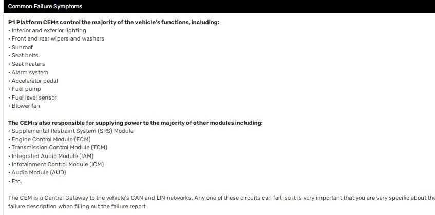

If electrical is your enemy - you may have a hard time solving your problems - by throwing parts at it. It's going to take someone who understands modern CANBUS electrical systems and can find the common thread. If you want to tackle a wiring diagram yourself - yours can be found at volvodiag.com under the EWD tab at the top.
A good first step (I trust you have checked basics like battery connections) would be a scan with a compatible scan tool, one that can talk to and activate all the control units. The best choice for that is VIDA either with a subscription or the hacked 2014d easily found free on the internet. You might have a problem with the CEM - you would need specific Volvo codes if you end up sending it off to xemodex. Common symptoms courtesy of xemodex
