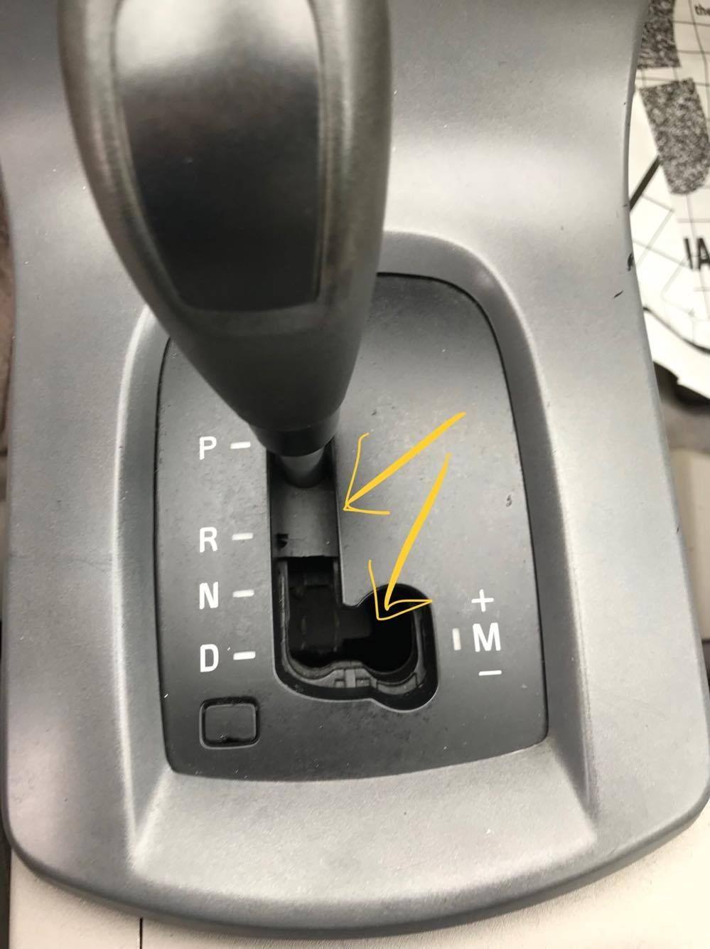

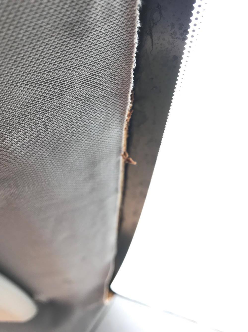

I am seeing a lot of various post about the P0171 code after reading through the forums. My questions is concerning the remaining information that was listed after the P0171 code? Are they all tied together with that code or do they represent separate issues that I need too address? There is also some issues with the headliner and side door panels, any recommendation for fixing the areas where the headliner is sagging for come loose? There is also the plastic pipes that slides with the gear shifter that is broken, and ideas on a part number just for that piece? Thank you!

The hole in the shifter cover is a rubber piece that has worn out and broken. The reverse side of that piece is notched to flex and wears out over time. Replacement is super easy.
