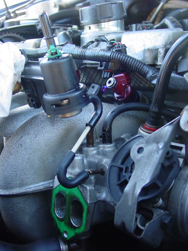

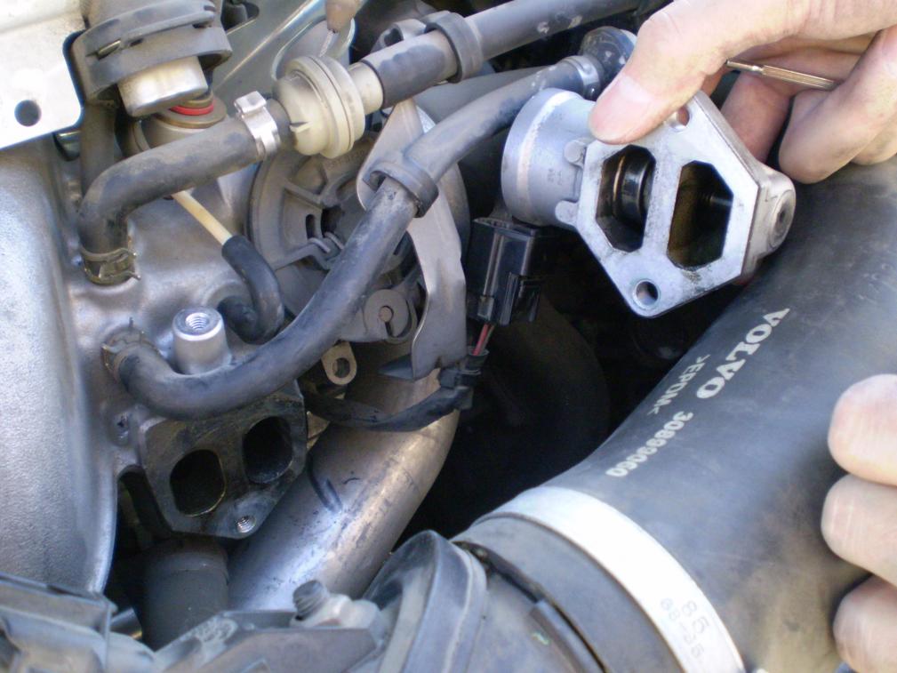

Is it in either one of those pics?

It bolts to where the green gasket is in the 1st pic. The second pic someone is holding the idle motor.
