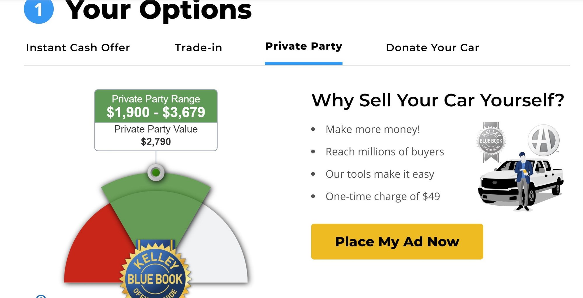

Old Nov 14, 2022 | 04:06 PM
Originally Posted by mk6angelo
2007 Volvo S40 T5 AWD model and it has a blown headgasket. what other service should I do at 165,000 miles, and is this T5 equipped with an RN motor?
A "blown head gasket" came from running the car out of coolant. Unfortunately that car is one of the few Volvos that does not have a low coolant warning system. A typical warped head repair is several thousand dollars retail plus the cost of whatever made the coolant disappear. Kelly blue book thinks a 07 with 165k is worth about $3000 if almost perfect. But you have no history, or knowledge of the car. I have purchased several cars like that that have had large failures from my customers - but I knew the car and it's history and would only purchase them if the body and interior were perfect. I usually pay $500 to $750. I would not touch that car - it's not economically reasonable to purchase and fix it. And that's the reason he does not want to fix it. He won't have to worry - there's someone out there foolish enough to think they can fix it for cheap.

Old Nov 14, 2022 | 04:12 PM
Likes: 540
As with any "mechanics special", the price of the car should be discounted to cover the cost of the repair at a pro shop. A check on KBB.com suggests the fair market value for that model/mileage in "good" condition is about $4000 maybe $5000 if in very good. The cost to do a head gasket including machine shop time to straighten a warped head is probably $3000 so $800 seems to be an honest offer.
Have you seen the car to know its general condition other than the head gasket issue? a T5 with AWD is a fairly desireable model so that's a plus.
If you can do the work yourself, assume you will spend $1000 for the machine shop (or a used replacement head) then another $500 for other parts. If you do the labor on your own, you can have $2500 into a car that is worth $4000 so it sounds like the question comes down to your skills and time to do the work.
I'd say the next step is to do some homework - call your local machine shops regarding straigtening a warped head, call some local volvo friendly indy shops about their cost to do a head swap, go to car-part.com to price out a used replacement head and then crunch the numbers.
PS - I did some spot checks on Autotrader and you can find similar year/models in the $5000 range (that's the dealer asking price, not the final price) so that's also part of doing your homework.
