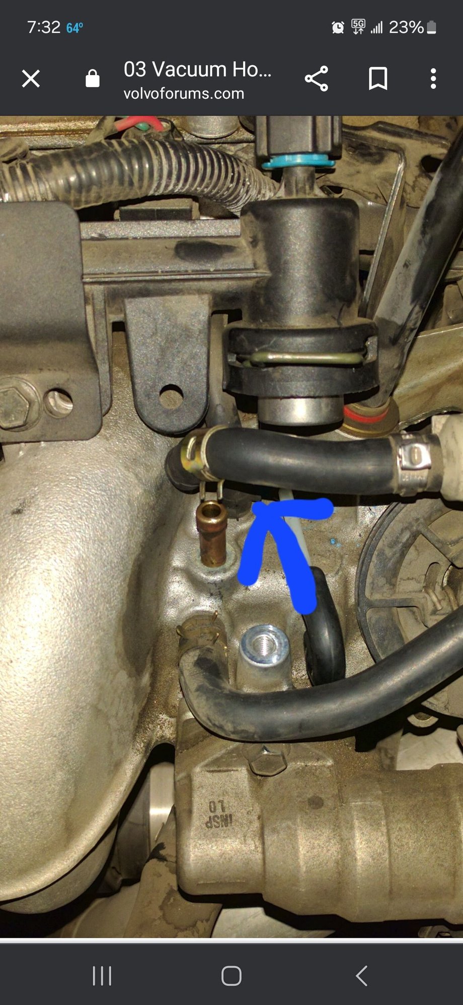

Need help locating where this hose goes too

Ummmmm.... maybe the obvious right-size nipple that's almost touching it?

I got this picture off line so on my car there is no hose there

Then put one there (seems that you even have a link to buy one from rockauto in the post you linked).
Or am I missing something?
