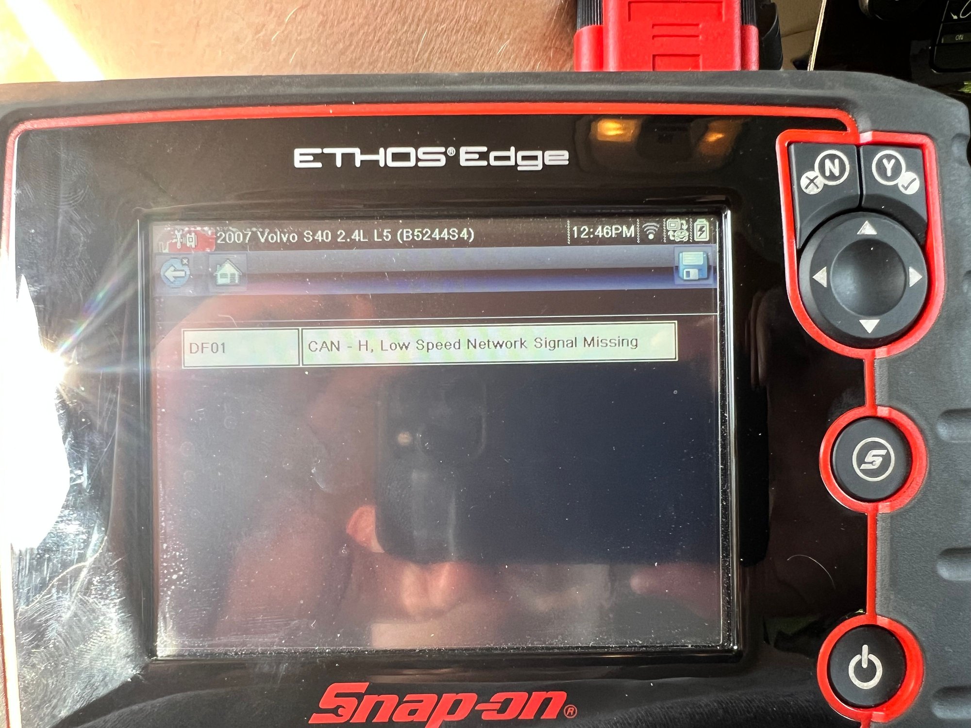

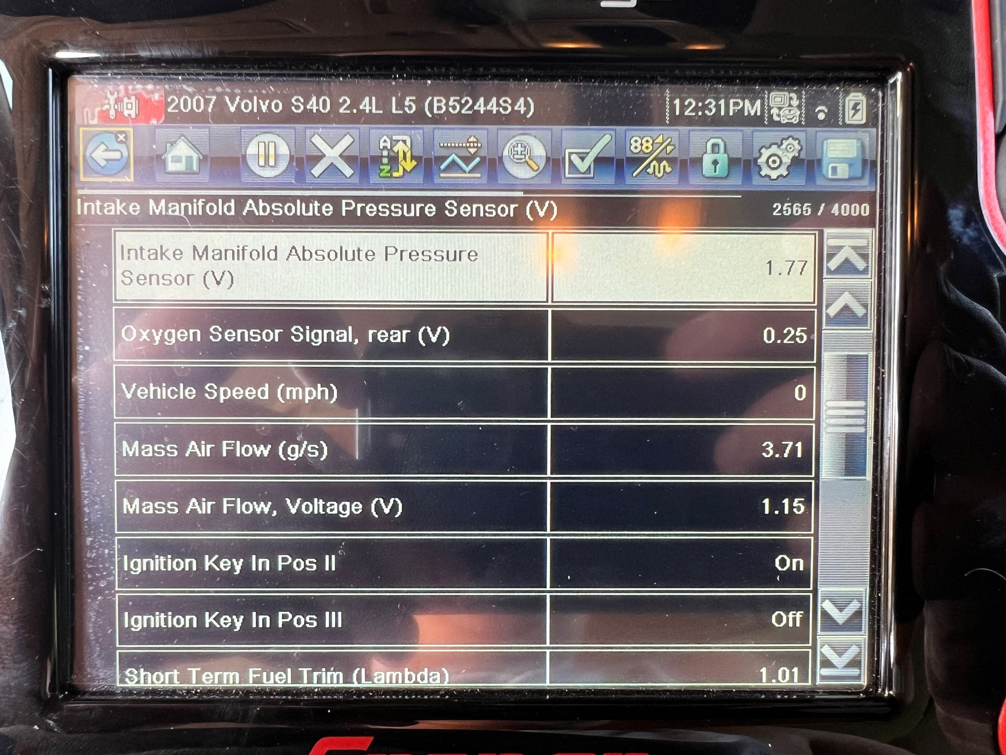

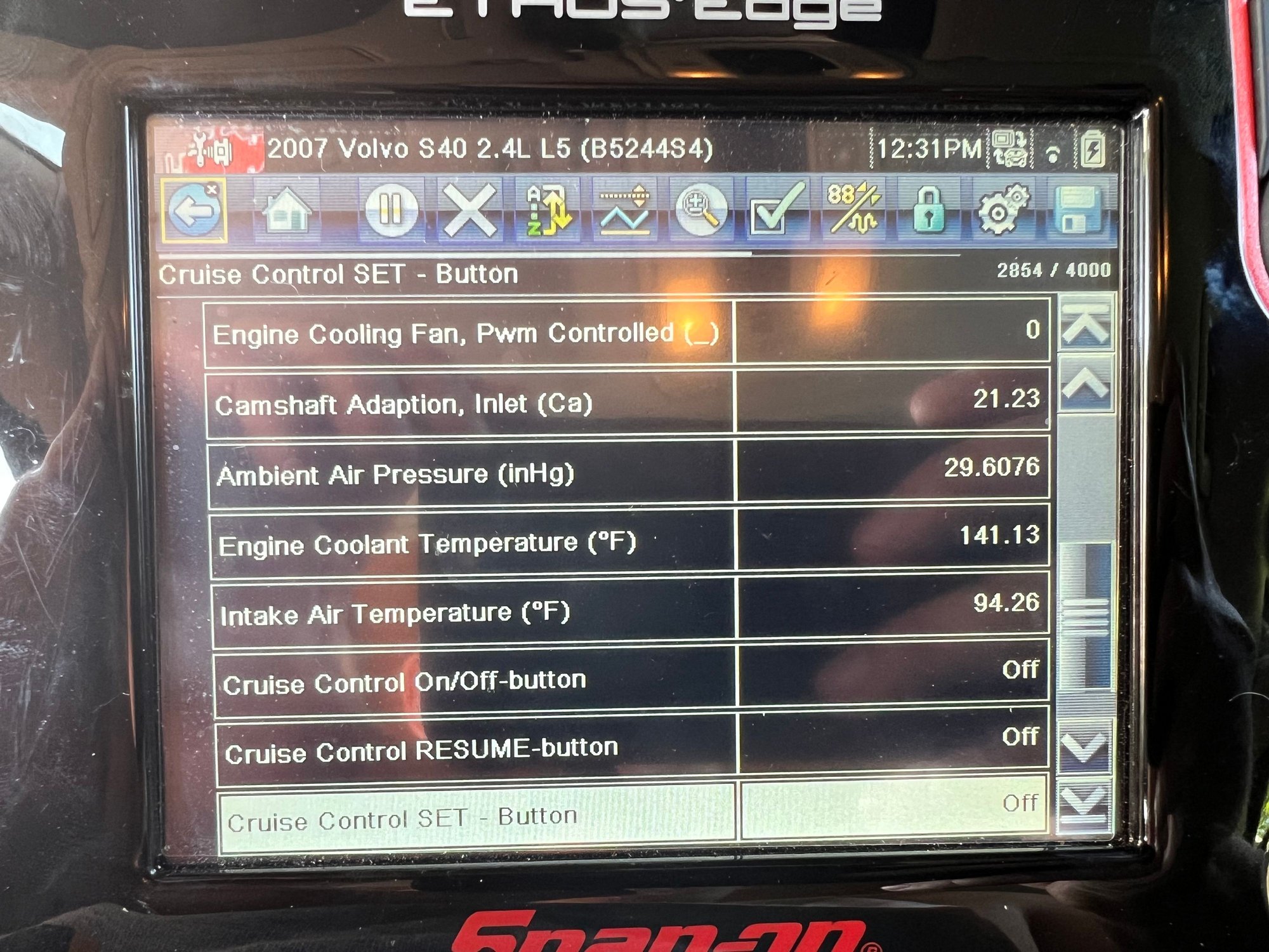

Old May 8, 2023 | 03:17 PM
Rdavid25's Avatar
Joined: May 2023

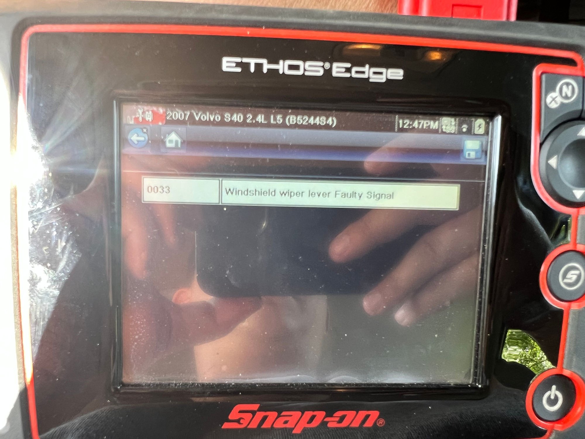

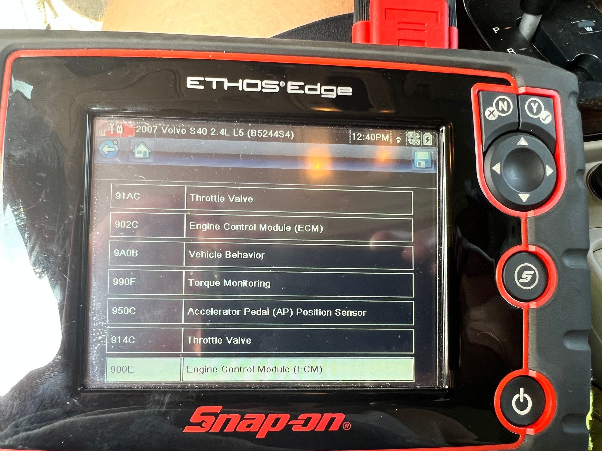

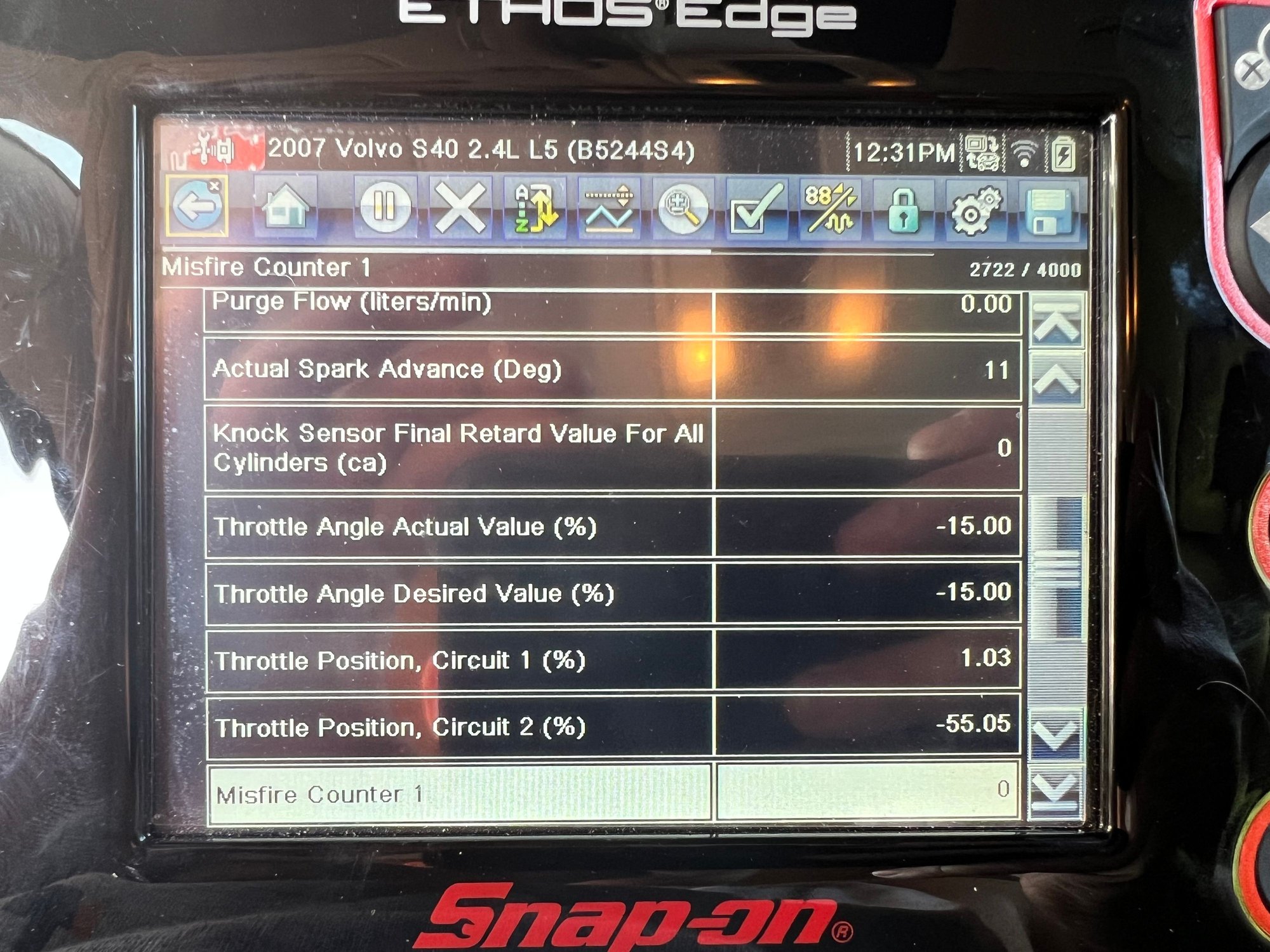

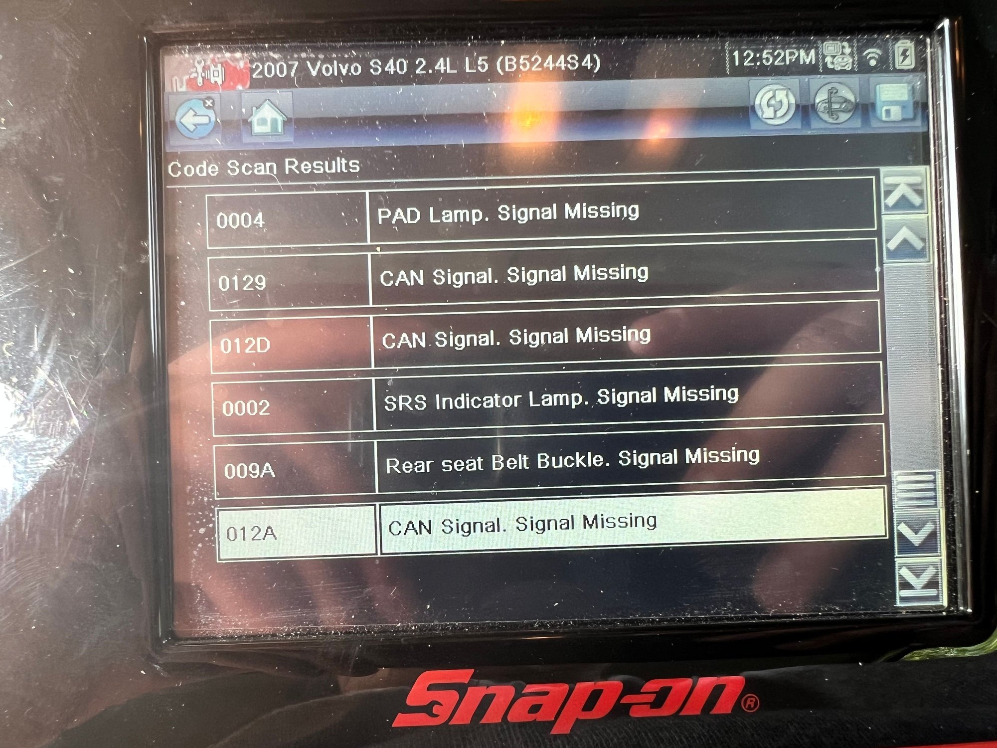

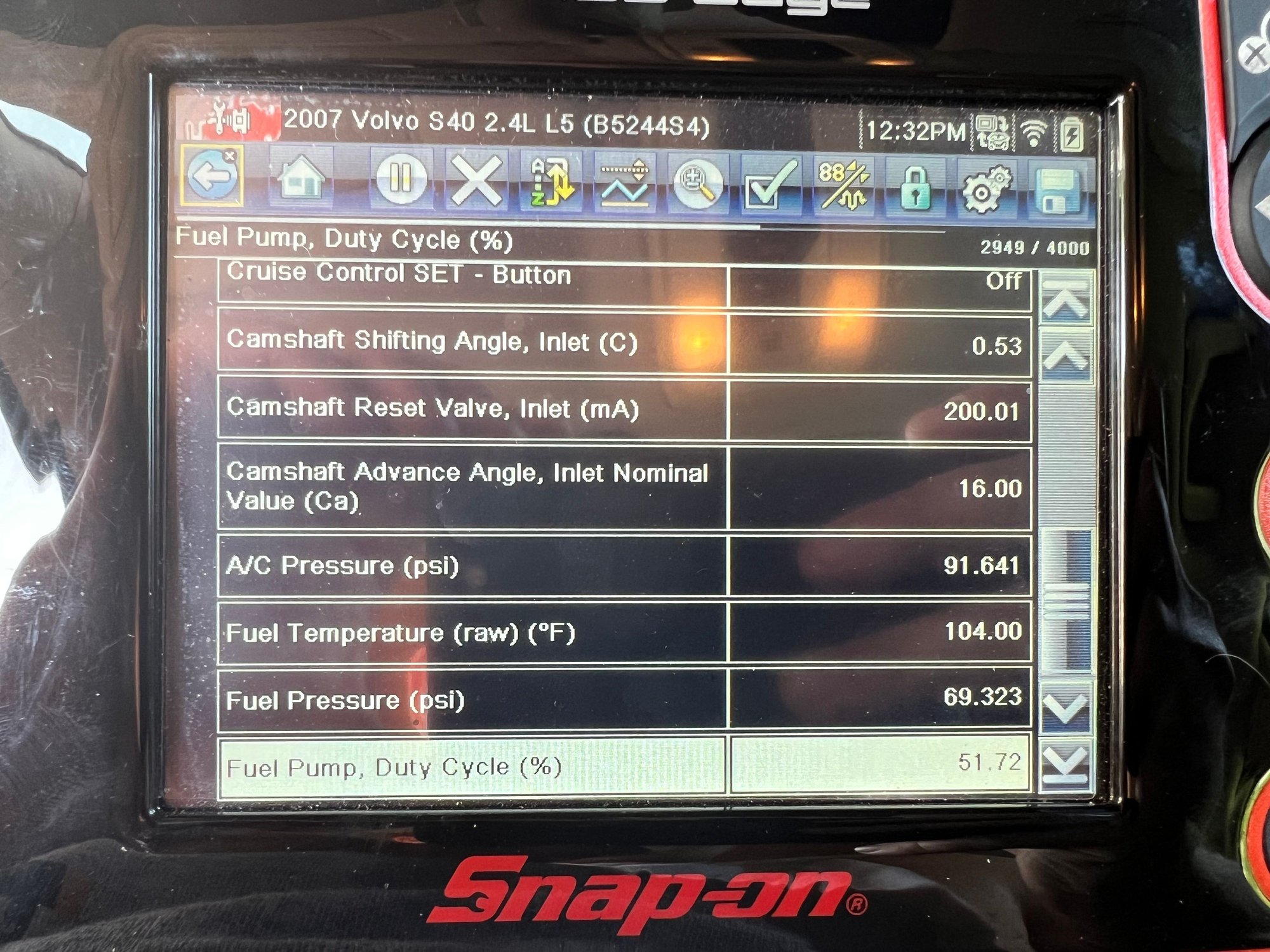

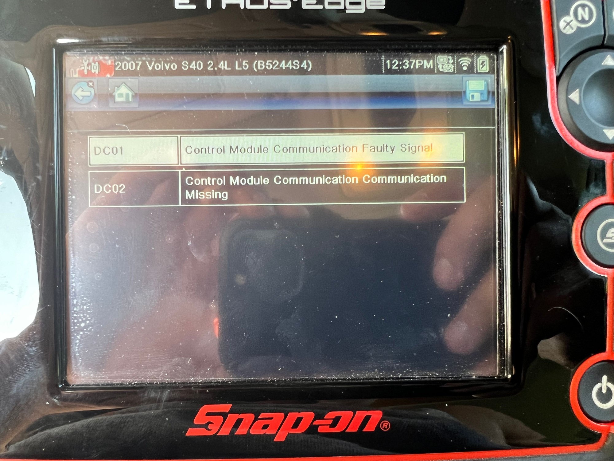

Default Codes form scanner
habbyguy, hopefully you’ll have a second to look at all of these and see if you see a common issue or something that I can check. Thank you!
Old May 10, 2023 | 01:41 PM
habbyguy's Avatar
Joined: Feb 2013
Posts: 1,372
Likes: 112
From: Mesa, AZ
I'm not up to speed on a lot of those variables, but all the missing CAN signals points to a problem somewhere in the "digital backbone" of your car. With those signals not present, lots of things can and will go wrong. I have zero experience troubleshooting these in a Volvo, so can't be much help - I do know that you'll probably need an oscilloscope to troubleshoot the system, but can only suggest you search on the error codes and descriptions for those "missing signal codes" to see if you can find something actionable.
Again, if you had a working VIDA system hooked up, it would probably point you in the right direction, so it might be a good play to check into getting a laptop loaded with the software and getting your hands on the appropriate cable(s).

My brother in law owns an auto electric shop and he suggested checking the ground. So I made a temporary ground and I waited about 10 minutes, started it, and all the messages and warning lights were gone and it idled normal. Unplugged the make shift ground and the lights came back. Looked under the car and the ground wire bolt is rounded off and the connection to the engine block is all corroded. Going to get wire tomorrow and make my own ground. I’ll let you know if that’s the final solution!
