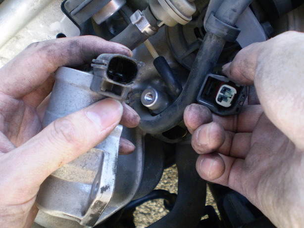

Finished the IAC cleaning today, but I'm still looking for a new gasket. Following I document the process:
step1, remove the 2 bolts, it's eary to use wretch to remove the upper bolt, but the bottom bolt can't be reached, at last, it was removed by hands.
step2, lift the plastic tab and push down to disconnect it. then unplug the the wire.
step3, spray the cleaner, and remove the dirty.

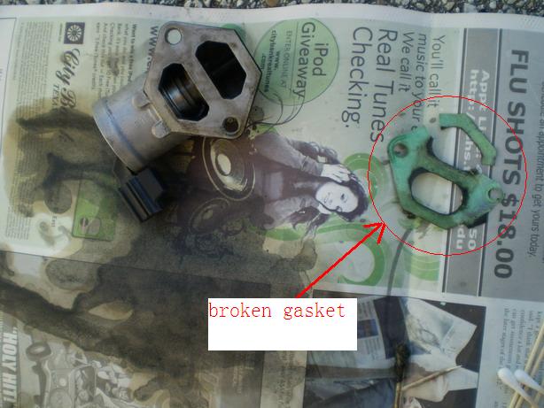

open issue, the gasket is wired out, crispy and broken. where to get a new one?
and, how to screw tightly the bottom bolt? Any advice will be appreciated.

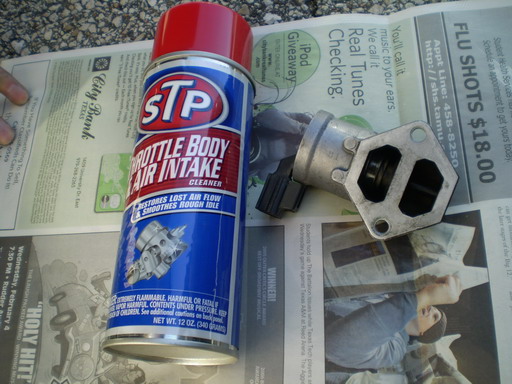

Question about the throttle body and air intake cleaner you used. Doesn't it say not for fuel injected cars or something in the instructions? I bought CRC stuff to do the job and it says not for turbo cars?! WTF? It should be fine anyway. Just wondering.

I'm sorry I couldn't find any local Volvo dealers to buy the gasket, and I have stopped by Autozone and Autopart shops, the guys told me to go to 'volvo only'. Now, the broken gasket is installed. I don't think it's good enough, someday I have to visit dealers in Houston to get new one.

I don't find any like 'not for use with fuel injected vehicles' in the instructions and attached 2 pics here. If the compressed pic isn't clear pls leave an email to which I'll send the previous ones.

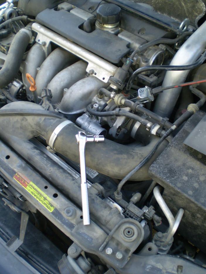

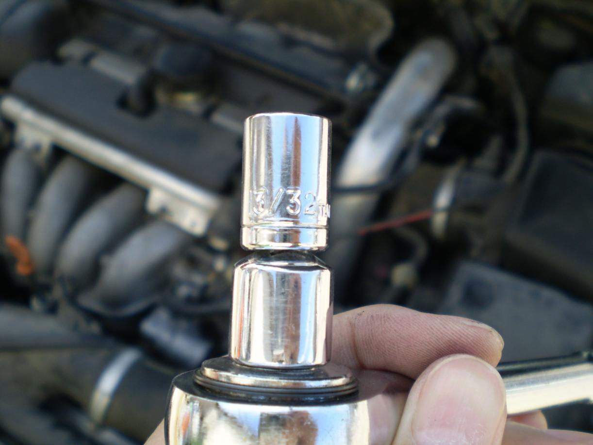

I have a good news for I have found the tool to screw tightly the 2 bolts, especially the bottom one, of the throttle body. Please have a look of the attached photos of the screw-extension for reference.

I'm thinking if the new gasket isn't available, maybe I can buy a piece of gasket material and try to have a trim, simulating the shape of old one, by myself to get a new one.
Do you think it's feasible, sir?
