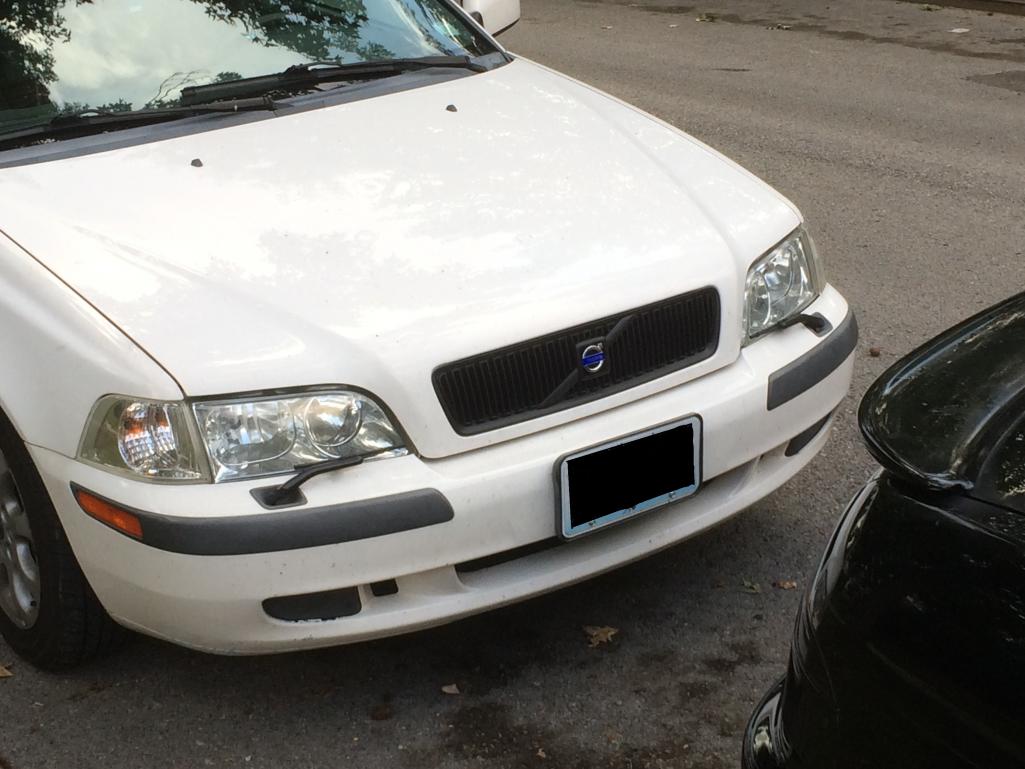

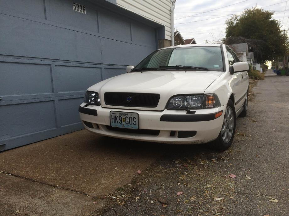

I had the same issue with my headlights, as soon as I touched the damn thing it fell to pieces. I was able to connect it long enough to get me home, long story short both adjusters broke when I tried to press the connectors on and I ended up getting new assemblies on both sides. TYC makes a great oem replacement assembly. I opted to get the black bezel I thought it looked better than the chrome. also got matching turn signals. My advice get the part # from Oreillyauto.com and get it at a better price on amazon.com. I got everything (bulbs included) for $250. I attached a before and after so you could see what it looked like on the car.
Man, you are right - the black looks tons better (especially with the white car)...I may have to consider that upgrade.
