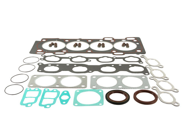

So, I got my head gasket set and I'm about to start putting everything back together.
But I'm confused about these silver rectangle gaskets with 2 holes in them.
It seems like an exhaust gasket but I can't figure out where its going. Can anyone help me?
Also, is there 2 different intake manifold gaskets in this kit? This is confusing me.

The exhaust gaskets go between the exhaust manifold and the head. If you left the exhaust manifold in the car it makes it a bit challenging to get them in place due to the limited working space.
There are extra gaskets in the kit. I just replaced what came out with it's new counterpart. Don't forget to seal the cam cover with RTV. It will leak otherwise.
