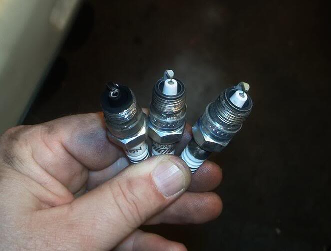

What do your spark plugs look like? Are all 4 oily black? Or only the one?

There is only one black plug, but if I drive long distances it's not black much.
When engine start-cold, it's smoking blue a little bit on low idle and very bad smell <not like petro engine> but when is worm it's much better.
I use semi-synthetic 10W40 and replaced it 1000km ago with filters, but after 200km was black, like diesel one.
Will repeat the test again(mayby saturday) and I made mistake in prevoius post- I put diesel into NOT oil- sorry for that.
