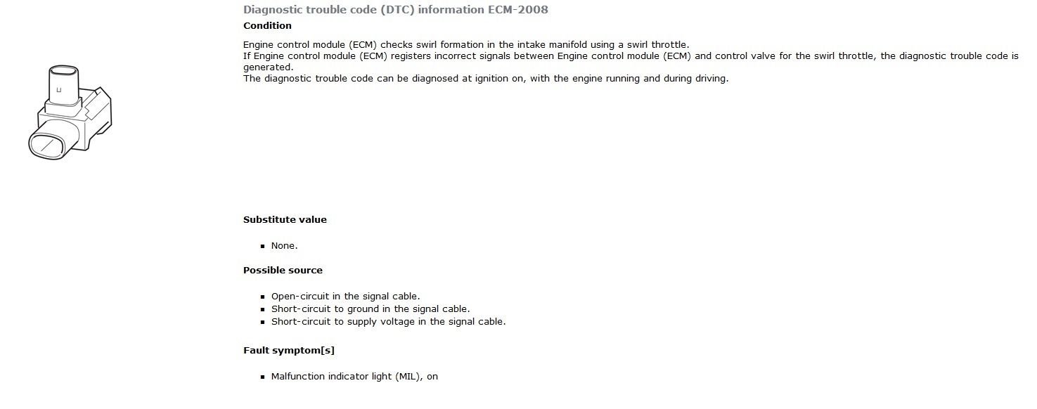

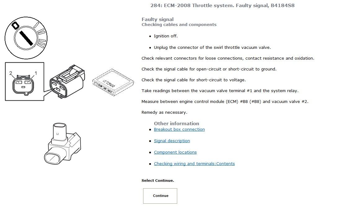

It says p2008 intake manifold runner control circuit open bank 1
Old Feb 7, 2022 | 01:14 PM
Here's what Volvo says about that code. Part # is 31375551 if curious.
