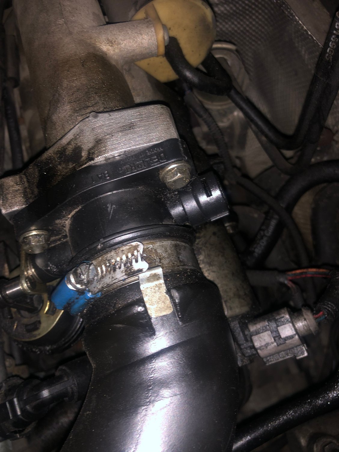

Is there a particular reason why my car would act like this? What would be a potential cause for this behavior? It is worth noticing that there was quite a big leak of oil coming from the throttle body. After I cleaned the throttle body, I didn’t see this oily mess yet. Where should I look further for the culprit in your opinion?
