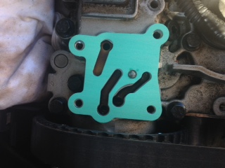

Is this dry enough? Here is a view of the gasket (dry) the sol face (dry) and the head surface (dry).
I took it for a test drive, maybe 10 miles. Checked the leak situation and all seems to be ok. My daughter will drive this week and I will check periodically. My fingers are crossed.

Yep, that's how its done.
