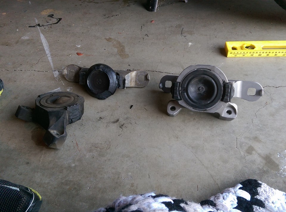

Our cars are also known for the main engine mount to fail. Makes a weird sound when it gets down to metal on metal.
Failed one on the left in 2 pieces.
