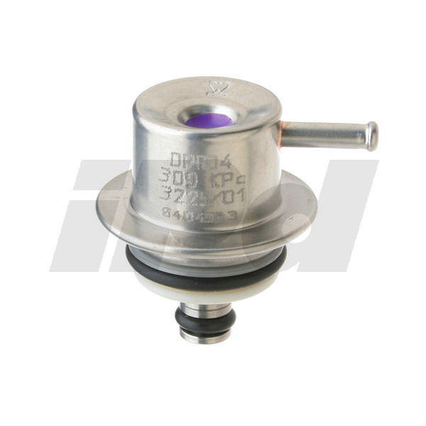

Have a nice day. I try replace my fpr, but i dont know if just replace the metallic part (pn 9404587) or a complete black housing.
Jose
S40, 2000, 1.9T
Thanks by your answers.
Attached Thumbnails  Fuel Pressure Regulator Install Question:-13785.jpg
Old Jan 29, 2009 | 09:46 PM
tech's Avatar
Joined: Sep 2004
Posts: 36,349
Likes: 46
Some have replaced the metal part only and others have replaced all.

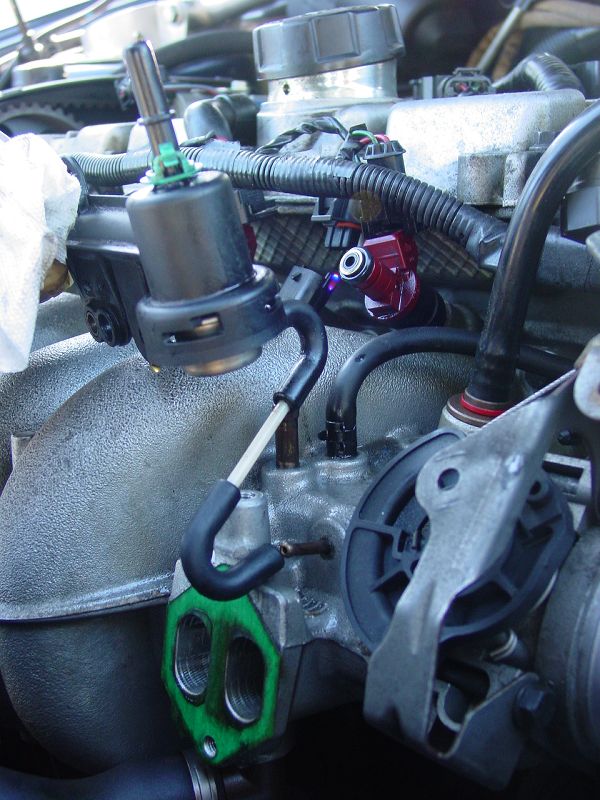

So dealer wants $400 for FPR and install! NO WAY!
I need to know specifically what to pull off to check for fuel. A labeled picture would be great! (please!) I did take off the TB cover to have a looksee and there were no visible signs of leaking, but the little hoses had some cracks. Car is now doing long cranking even after 20 mins of sitting if the temp is over 30 degrees outside. Someone mentioned my injectors could be leaking, flooding the engine with fuel. Do you concur? Is that a common thing? I only have 90,000 miles. That seems low mileage for something like that!
Thanks tech!
Old Feb 3, 2009 | 08:28 PM
  #18
tech's Avatar
Joined: Sep 2004
Posts: 36,349
Likes: 46
Remove the cover again and you will see a hose white plastic with an elbow on each side.
It kind of looks like a S remove it from the intake and see if gas comes out. Sorry don't have a pic.
Old Feb 4, 2009 | 03:57 PM
  #19
Lyonsroar's Avatar
Joined: Jun 2008
Posts: 685
From: Omaha, NE
Got a pic from a guy on s40concepts.net
Will post it here for future newb reference!
Just like that right?
And should I do it shortly after a drive or wait a while?
Thanks a lot!

Old Feb 4, 2009 | 09:23 PM
  #20
tech's Avatar
Joined: Sep 2004
Posts: 36,349
Likes: 46
Wait a while after driving it to check it.
