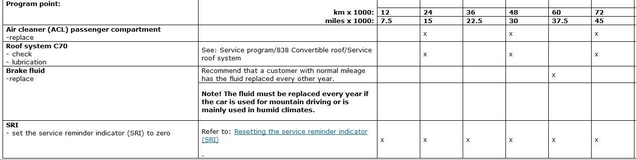

Brake fluid should be flushed every 2 years/37.5k or more often in certain cases. Flush as in bleed all the old fluid out until the clean fluid fills the system. Certainly a turkey baster to remove as much from the reservoir is a good start - then new fluid is pushed or pulled through the system until it's clean. There are many cheap fluid test tools out there - to see how much moisture is in the fluid. From a Volvo service schedule -
