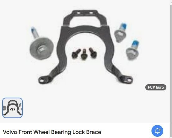

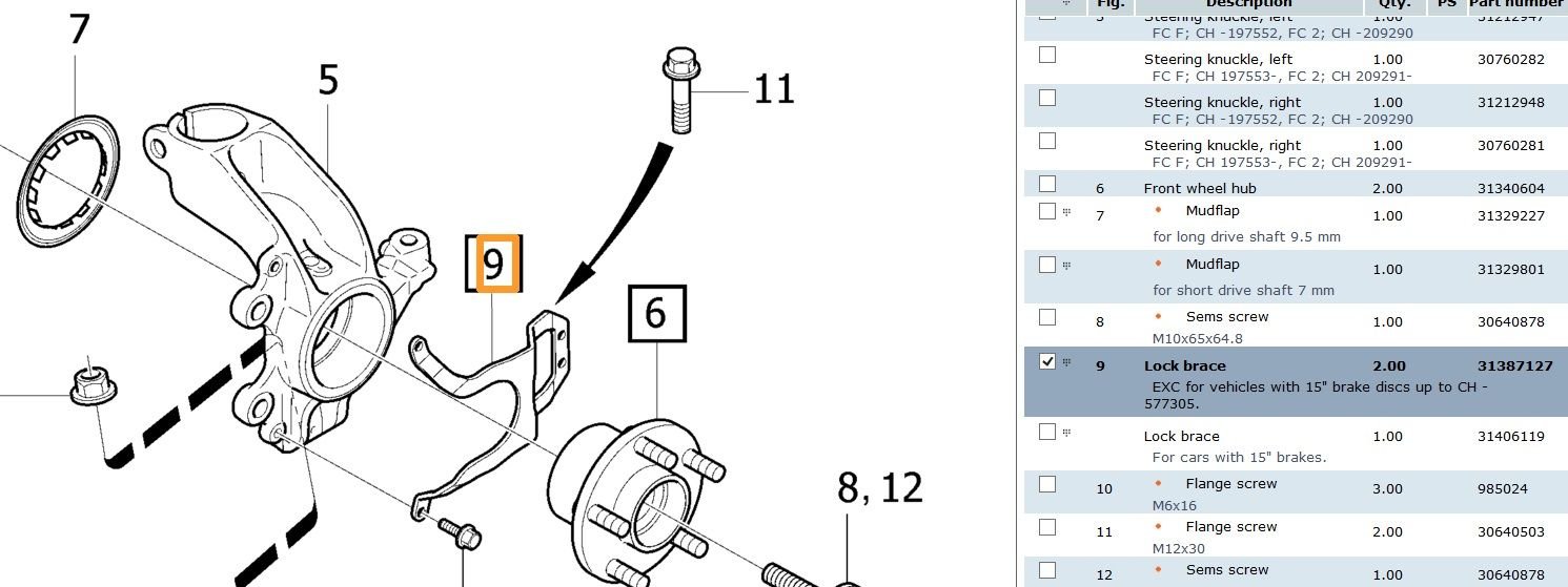

"The Problem:Grinding front right wheel"
The front wheel bearings are pressed into the steering knuckle. Some cars were built without any retaining mechanism ( a "lock brace") and the bearing will try to "walk" out of the knuckle. This can cause the brake rotor to hit the caliper and other problems. Have your shop make sure the bearing has not moved and the "lock brace" is installed.
https://www.fcpeuro.com/blog/how-to-...jE1NzIxNzA5NjQ.
