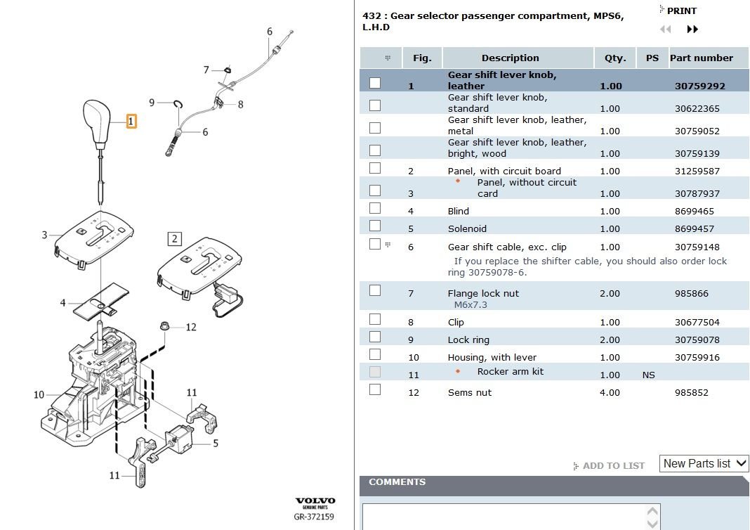

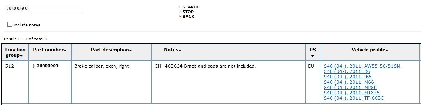

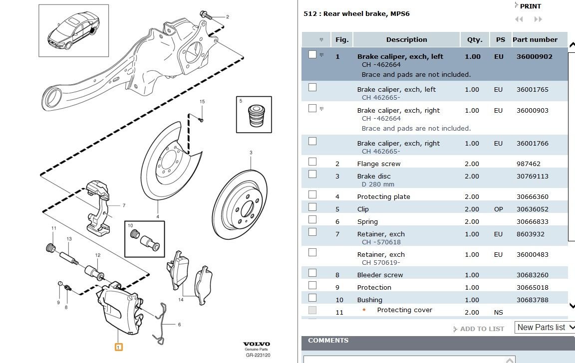

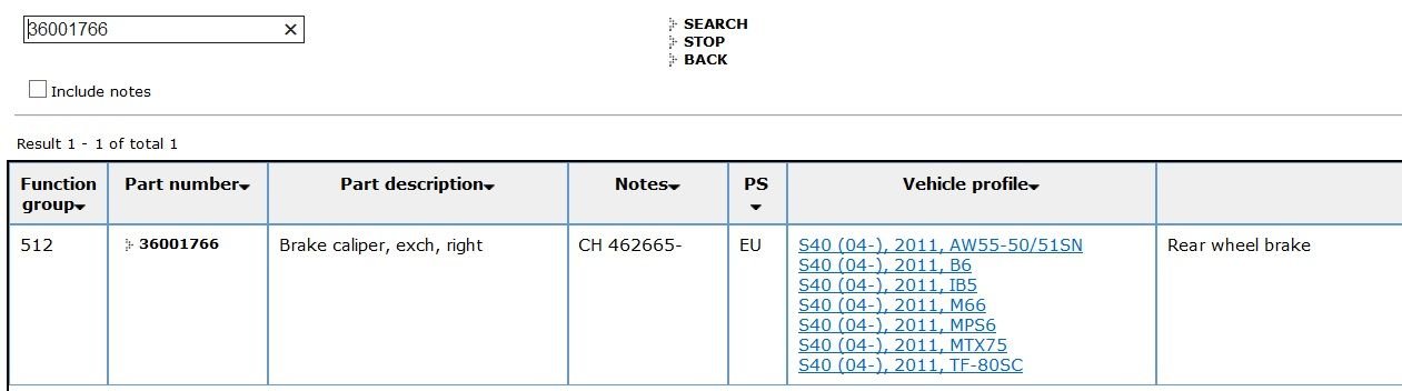

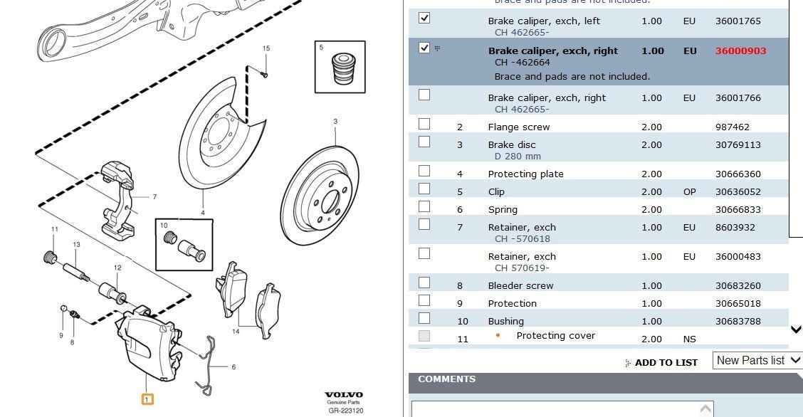

Old Feb 7, 2023 | 01:03 PM
Here's those parts pages
