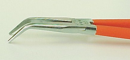

Snap-on sells a set of tool (universal) to turn caliper pistonback into position but its pricy.Or use aC-clampput slight pressure on the piston and use a pair of angled needle nose pliers to turn pistonin by using the tip of the needle nose pliers on to the 2 holes on the piston. as it move intighten c-clamp and use needle nose to turn it in until it goes in fully... hope this helps
C-clamp picture: http://www.flickr.com/photos/bimp/302374468/
Needle nose pliers picture: http://www.samstagsales.com/vbw/images/vbw577-015a.jpg
