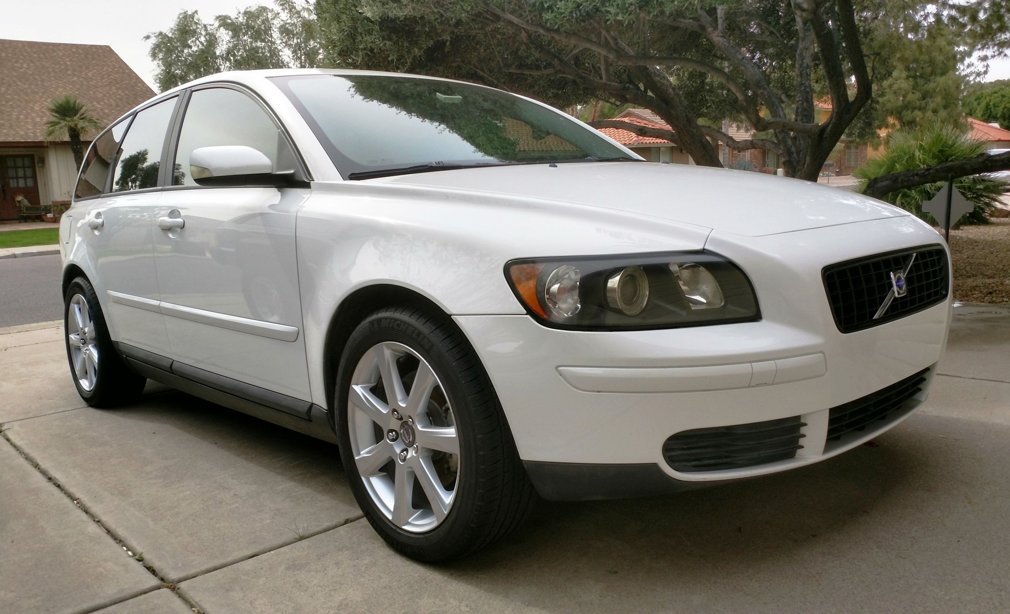

FWIW, I just put some newer V60 wheels (and wider tires) on my V50, along with spacers to move the wheels out closer to the fenderwells. Looked really nice, even at "normal" ride height.

To me, the biggest issue with changing the ride height is that the CV axles will no longer be in the "right position" so will wear out quicker, and could possibly induce some vibrations. When I first set up the V50, I calculated that I could use 32mm spacers, but the arc of the wheel movement brought the tire into contact with the fender lip / liner (carved a few chunks out of my tire sidewalls). I swapped them out for 25mm spacers and that seemed to do it, and looked pretty aggressive. FWIW, I also put in some camber adjustment bolts to counter (what I felt was) excessive negative camber. Doing that also brought the sidewalls out closer to the fender lips, so if you need to adjust the camber (can't be done without mods) you might want to do it before lowering the car.
And of course. lowering the car means it's more susceptible to speed bump / curb bites, and will handle less snow. But it CAN look cool... ;-)
FWIW, here's a photo of my (non-lowered) V50 with the 25mm rear spacers...
