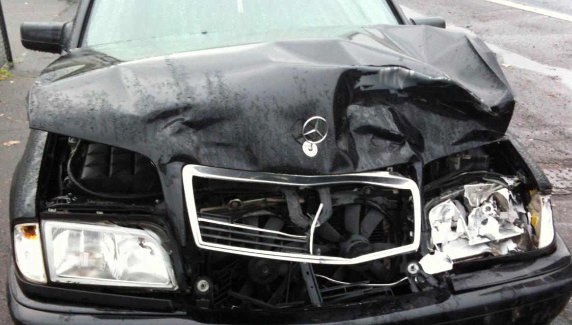

I previously owned a Mercedes 99 W202 c230k and currently 2005 W203 C230k. Warning is buy a well kept Mercedes with low miles and likely you will come away happy. A MB dealer will thoroughly go through a used car for $300 with a full report. This may sound like a lot but well worth the expense. Third party MB dealer is probably fine as well but the dealer will also have any service records on the vehicle. My W202 was an amazing car but began to have some electrical issues like power window and trunk went out. W202 is known as the last solid German baby benz. Super safe cars. I hit a deer doing 70 head on going down the Interstate. All three of the passengers walked away without a scratch. Car still drove actually if you can believe it - see pic.
