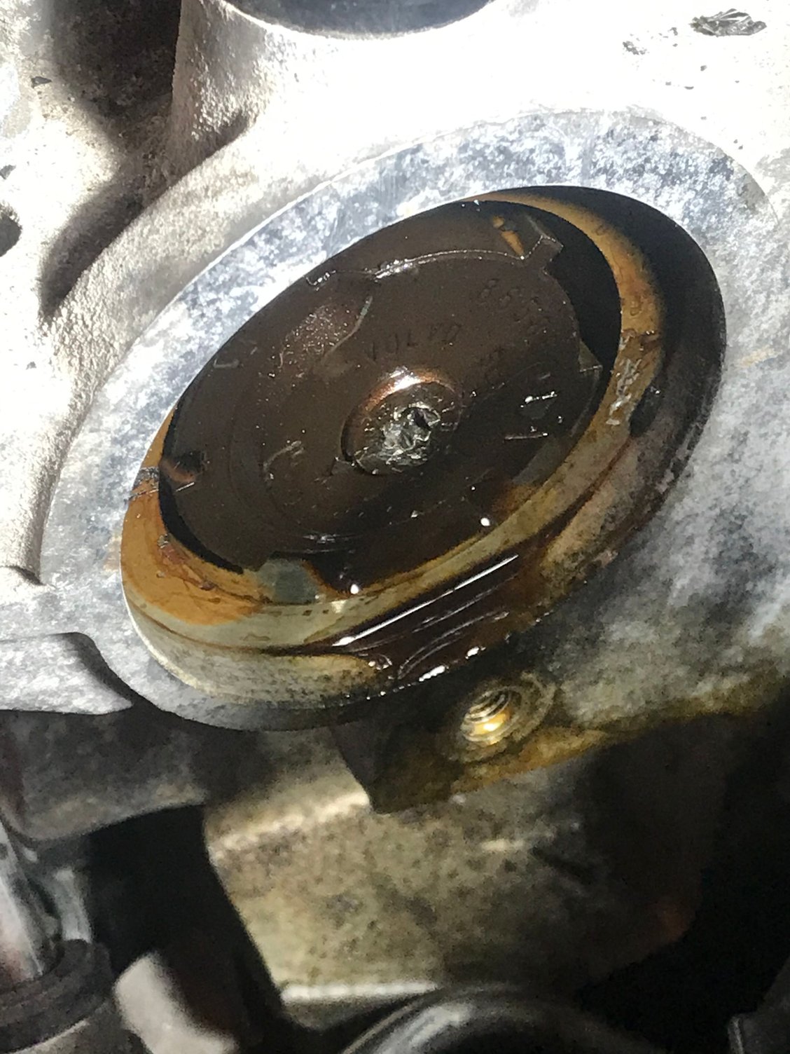

It did blow during an overheat situation. I’m in the middle of pulling the head and plan to check the head and block for any signs of warping. I’ve heard the same... could require head to be surfaced but have talked to a couple people who said it is equally as likely that it did not damage the head.
Out of curiosity... I have a cam alignment tool kit but have an issue. The intake cam at drivers side has a torx volt holding what I assume to be part of the VVT assembly... I’m not sure if I buggered it up while popping the cam cap out or if someone had done work before did. See attached picture. Any advice on getting this off? It’s not a reverse thread or anything is it?
Please let me know your thoughts!
Thanks!

Good luck on that head. You might well get lucky (but be ready to have the head milled, just in case).
I'm 99.9999999% sure you didn't do that to that Torx bolt pulling that cover off (unless you used explosives). ;-) I'm not familiar with the VVT mechanism, but my first thoughts would be to clean it up a little, then I'd hammer in a Torx impact socket as deep as it will go and hit it with an impact wrench (check to see if that will have any effect on the rest of the VVT mechanism, or figure out a way to render the part that's showing immobile first). If that fails, you could grind a slot in the Torx bolt and use an impact screwdriver of the appropriate size.

I’ve always trusted Torx until they get messed up and then worry they will strip out. Pounded a new driver in and got her to break loose. One less obstacle.
