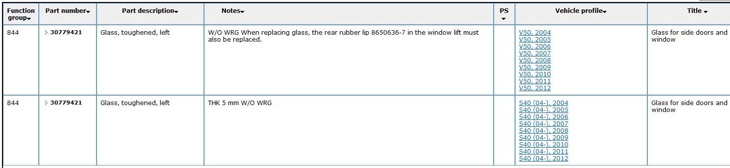

A drivers side window (for a left hand drive car) is the same (unless it's laminated glass) as the cars listed below

That's exactly what I was looking for, thank you so much!!! I was trying to get that VMware player working so I could find it myself, but wasn't having success.
I see it mentions a rubber lip that may have to be replaced as well? I hadn't noticed that myself or heard it anywhere yet. Does it elaborate?
Either way, thanks for your help, you answered my question seamlessly.
