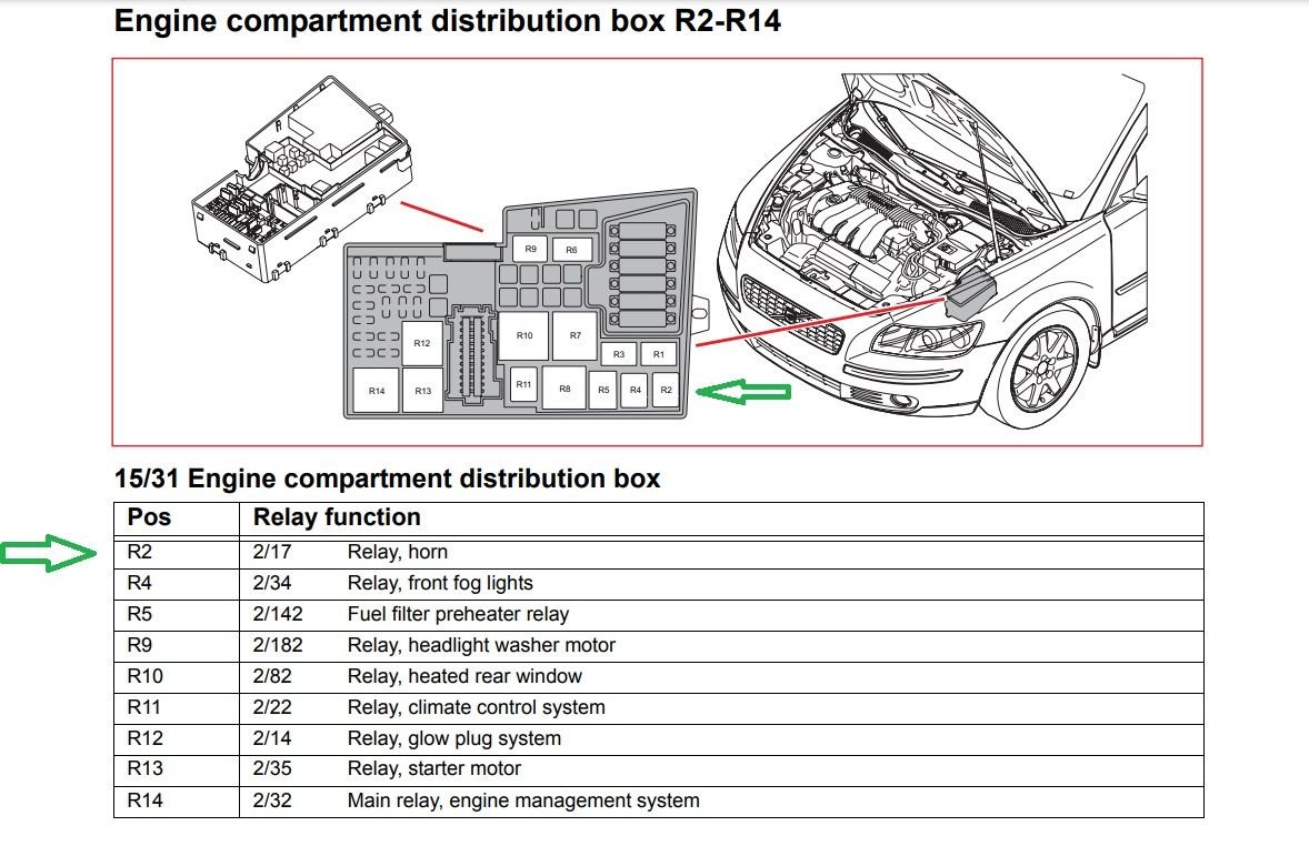

There is a horn relay and fuse (#20) in the fusebox under the hood. If there's another relay with the same part number - you could simply swap to see if it's a relay problem. A shorted horn could have possibly damaged the relay -

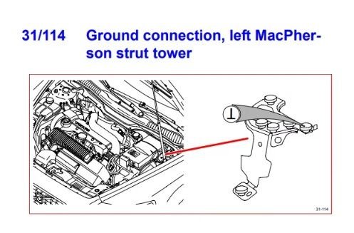

31/114 is supposed to be the ground. Try using just one horn to see if it will beep more than once.
