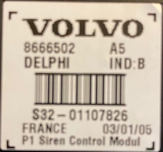

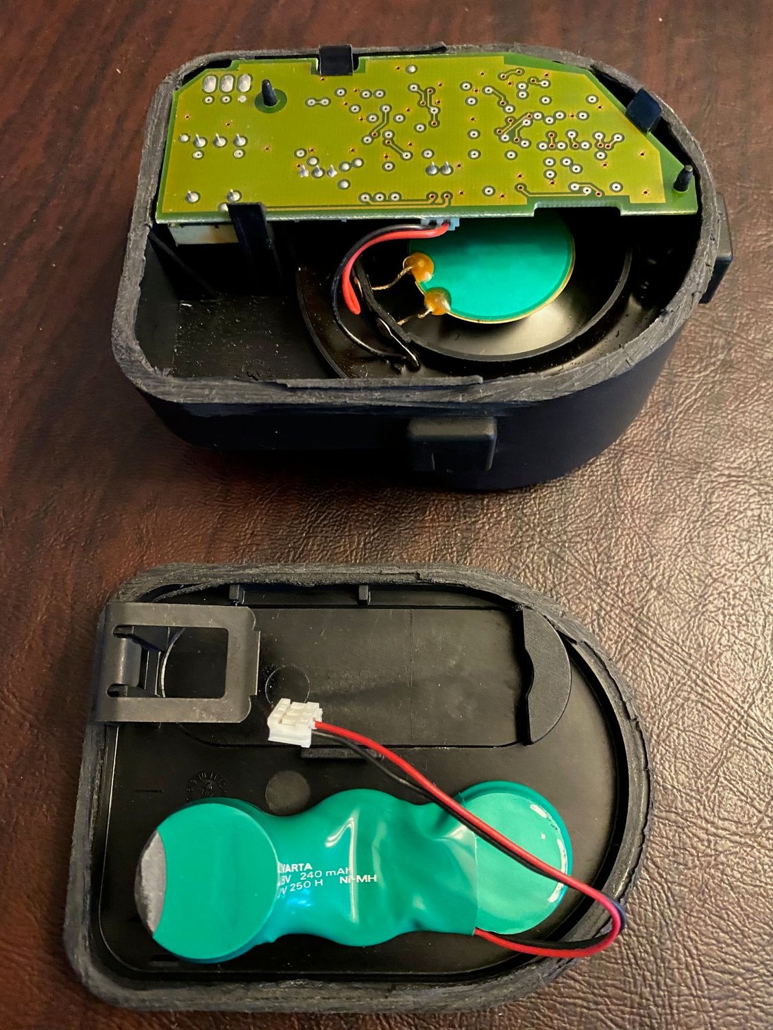

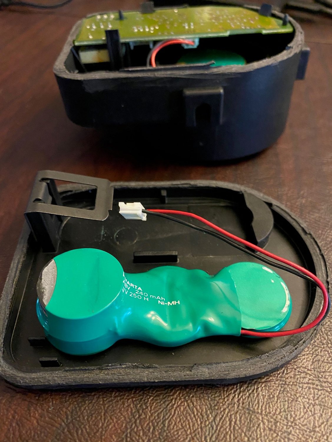

My son has been having issues with his S40 alarm going off intermittently, and as an inexpensive troubleshooting step, I swapped the siren module out with a later unit from the local junkyard. ($4 and change). Looks like the same module is used until about 2013. (on S40 at least). No issues with sunroof or any other components at this time. Onboard battery seems to have a nominal voltage in the original unit, and the board inside the module looks okay. Without a scan tool, the task of locating a faulty intermittent component or input to the CEM, would be a painstaking job, and one that the car does not warrant. Only time will tell, if the alarm will continue its random acts of annoyance. In the meantime, I am adding some images for reference, for those who want to understand the nature of the beast. Good luck to all !

If the siren was going off, there wasn't any chance that the siren module itself was the culprit.
I'd suggest locking the car (arming the alarm) and then wiggling / jiggling the hood, doors, trunk. You might get lucky and narrow down the search that way.
