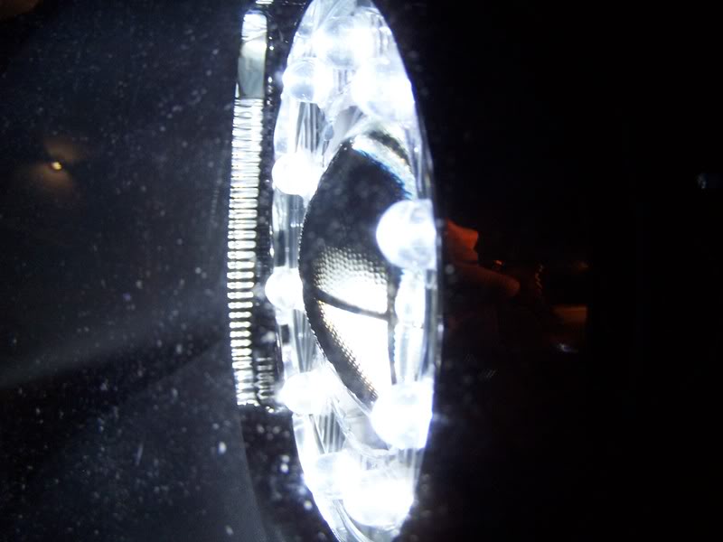

Welcome to the forum. All you need to do is open up the headlight and measure the diameter of the plastic ring that goes around the projector. Get the halos to match the measurements you take and install. Or you can go the route I did by drilling out 10 holes in the plastic and adding 10mm or so LED's.
Here's my old S40's custom angel eyes me and a buddy did so you can see better what I'm talking about...

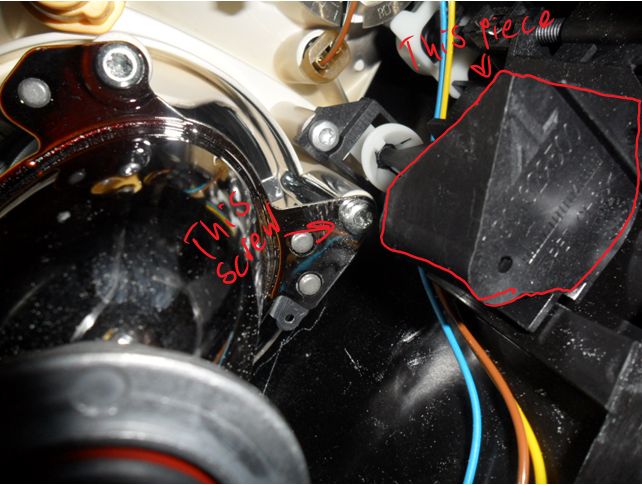

i had a problem removing the light so i could measure it in diameter because some screw was stuck behind a plastic piece that wold not allow the screw to exit its holder. the plastic piece would also not move. the link above is to a picture that shows the screw and plastic piece labeled because i do not know how to post a picture in a thread . if you could help that would be great. thx

I remember that damned screw. Lol. I was able to get it out with a torx bit. You just have to get at it from the best angel you can. IIRC I used a multi purpose screw diver with the torx bit attachment.

It's all about where you want to mount the angle eyes to. I think it would look best mounted behind the clear plastic ring that surrounds the projector lens. That way the headlights will still look good in the day light and not like something that you added. I could only guess that you equations are correct, like I said, I haven't had my S40 for about 3 years.
How are the angle eyes sold, In a strip that you can bend? If that's the case, go on the long side and you can overlap the strip so you wont have any missing spots in the halo. There was a guy on SS that got his too short and it looked funny cause there was about a 2" break in the light. Depending on how it's sold, you may be able to order it to length. Out of curiosity, where are you ordering the lights from?

Looking at those sights, you're right, it looks like they only sell replacement headlights with the led's and halos already installed. Gotta keep in mind here, we drive Volvo's, tuning and modding is not the easiest thing with these cars. And we have no where near the kind of product support that the JDM or other Euro cars have.
That said, You're gonna have to go more of a custom route, and build your own. It's more demanding but the look will be very unique. Maybe try to find a LED strip that you can attach to the clear plastic circle. Or Contact these guys to see what the dimensions of this kit is, or if they can get them in a larger or smaller size for you S40. http://store.sharphid.com/product_p/ddemz3.htm

Gotcha. In a short answer no, they will not get power. If you got a different car brand light, how to connect the lights would be the last of your worries. The overall shape of the headlight will not work for your car because they will not fit into the car. If want a replacement headlight that already has the halos installed you HAVE to get something designed specifically for the 04.5+ S40.
As of right now, if you want halos, the only way to do it, is by going a custom route similar to what I did.
Find some of the LED strips on eBay and install them behind the plastic ring and wire them to your driving lamps.

Nobody sells these lights, the design was created by another guy on SS and originally done by him with me helping. I further tweaked it a few weeks later with different LED's and a different wiring set up.
