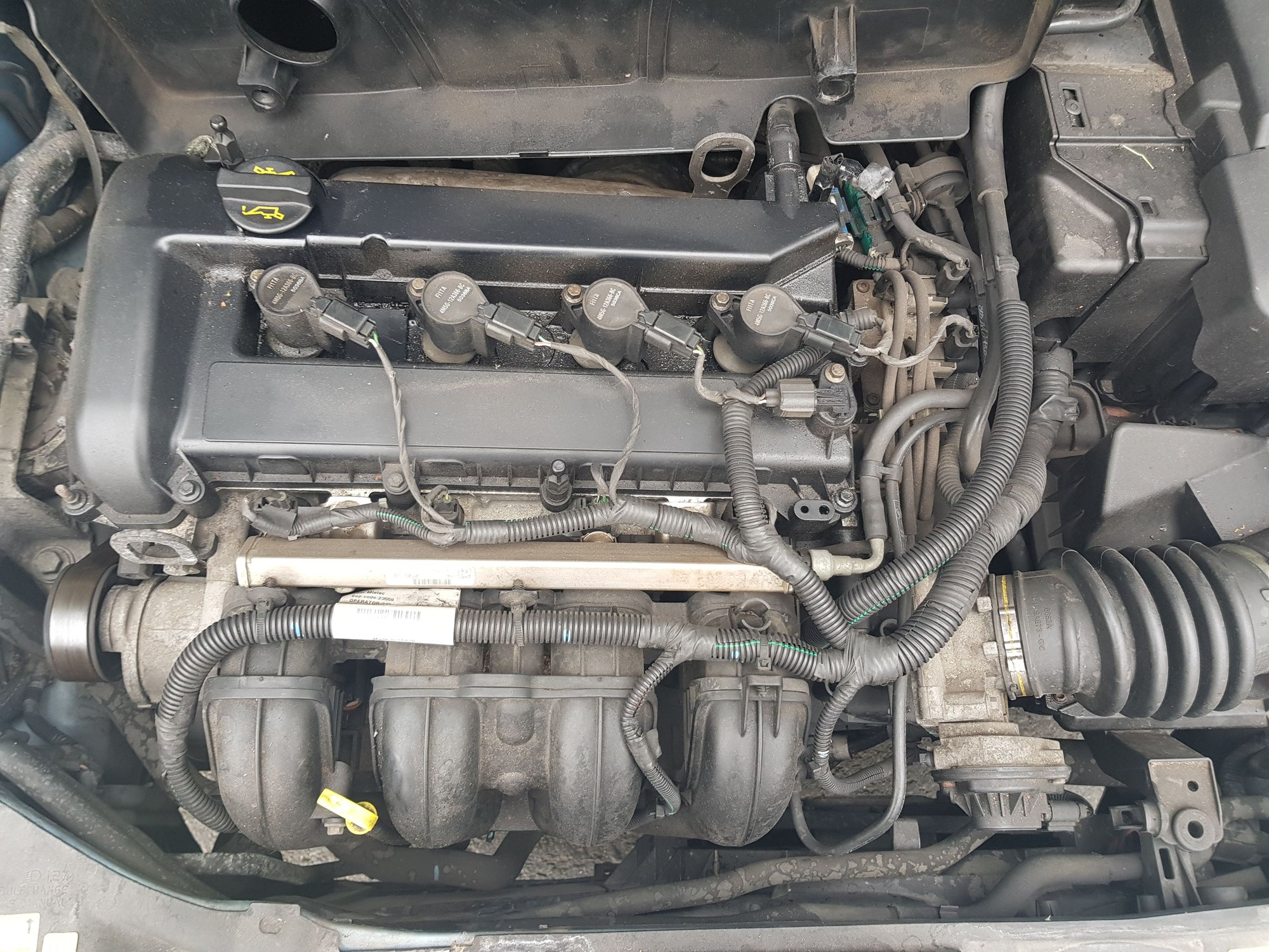

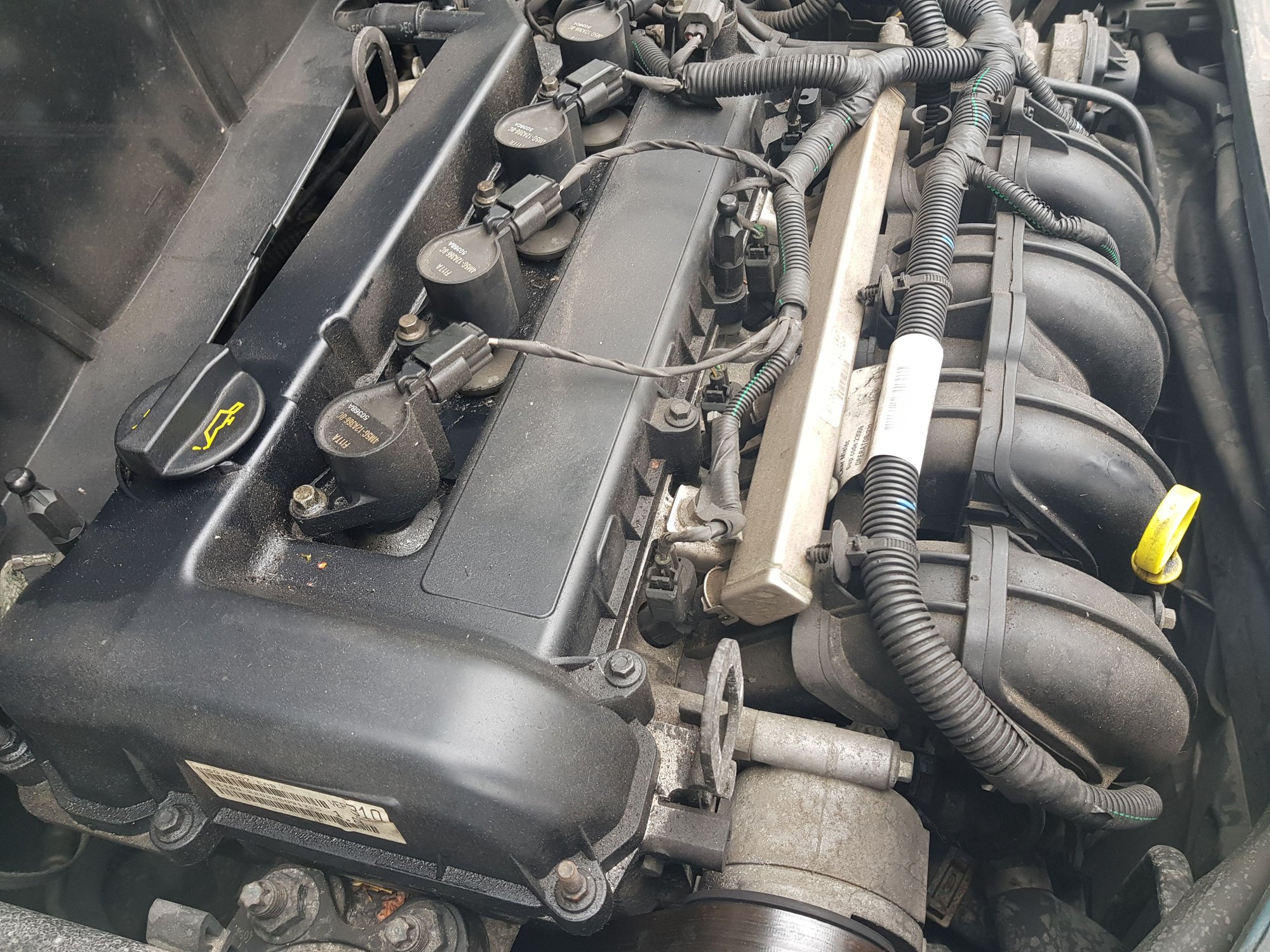

I can't find the fuel pressure regulator or vacuum hose. Can you please help me?
I attached pictures with the engine. Thank you!!

don't think you have a fuel pressure regulator only a fuel pressure sensor. On the Gen 1s the pressure regulator bolts onto the driver's side of the fuel rail and has the fuel line going into it. Looks like your model uses a fuel pressure sensor.

The engine code is
b4184s11
It looks like is 1.8 16v . How could I check if it got a fuel pressure sensor?
