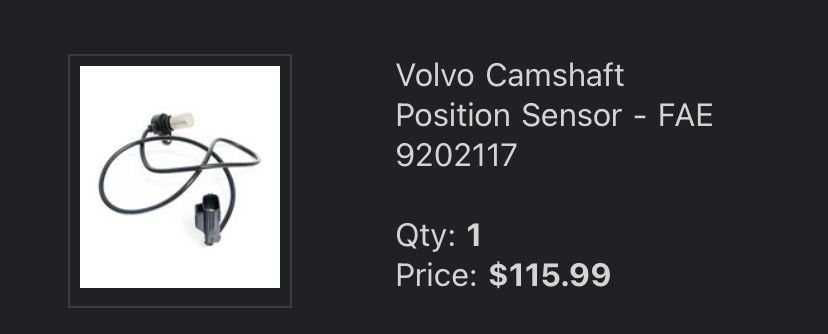

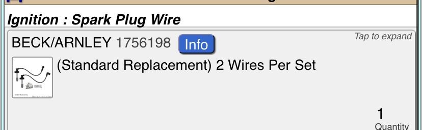

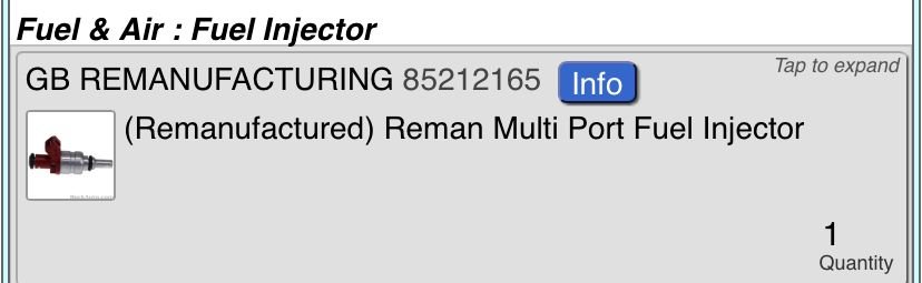

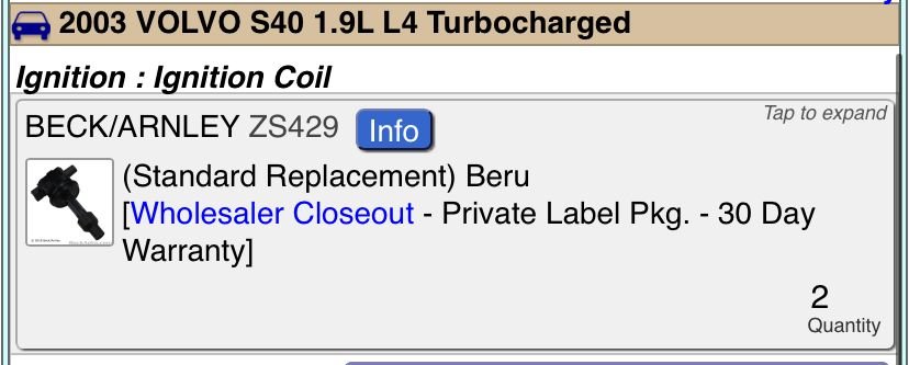

@habbyguy these are all the parts I’ve ordered, I ordered the cam sensor off fcpeuro which I figure they have pretty reputable and application friendly parts. Unfortunately all my parts are already at my house lol worse comes to worse I just have to send them back I definitely cheated out because my budget is pretty low and main goal is just to get running half decent.

The CPS is the most critical (most likely to fail if it's a bogus part) so you did good spending the bucks to get a "real one".
I wouldn't worry about the ignition wires - they're wires. ;-)
The injector is a bit of a risk, but I'd rather have a remanufactured injector (like the one you bought) than a no-name knock-off.
Coils - who knows? Those may be fine, and worse case, you can swap out a future bad coil easily enough.
Also, with coils, plugs and injectors, you always have the option of moving them between cylinders to see if the problem follows the part or not (something I always recommend before buying coils or injectors). If the new parts don't fix the issue, you can still do this to see if the new parts are causing a problem / misfire (it happens, and can send someone spiraling into an expensive parts-buying frenzy looking for the problem elsewhere).
