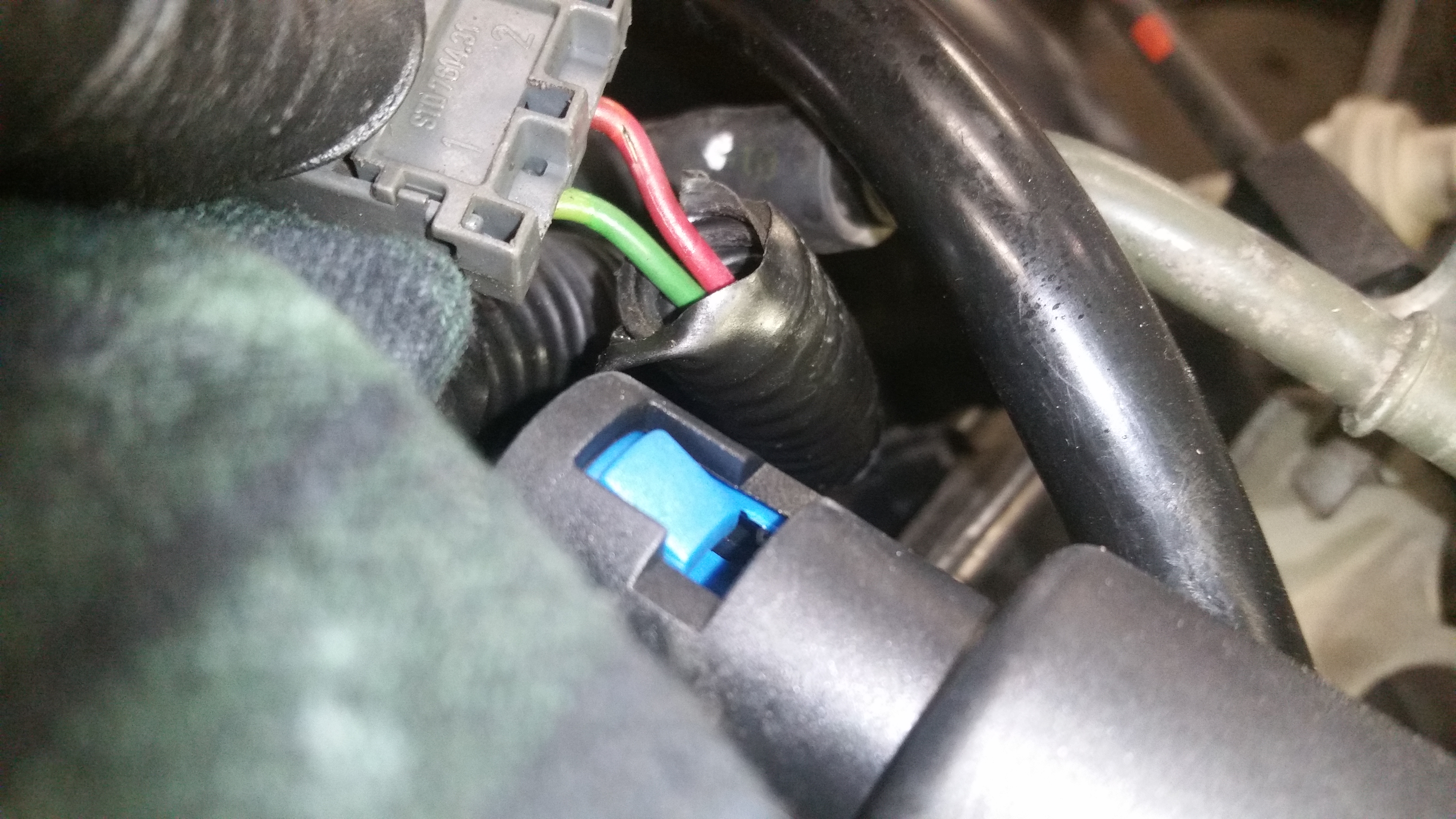

Sorry for my late response, problem solved. Tiny little crack in the wire that goes to the coil has been causing all the problems (see attached pic). It seemed like a ignition issue from the beginning but this car had so many dam problems. While inspecting I found my fuel pressure regulator was also leaking fuel into the vacum line and my turbo sensor had a code (replaced)when I first got the car. As I said above the car does pass a block test & compression test. I think who ever said (the milky on the dip stick it's just condensation) is right and I feel the head gasket is good to go. While I got it apart I'm going to do the timing belt. I appreciate the replys.
