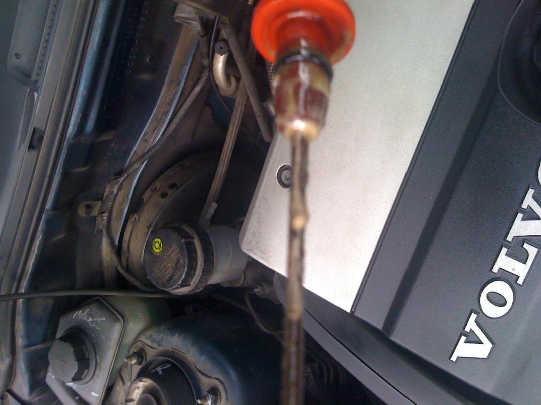

Here is a blurry picture of the dipstick.

Old Jul 3, 2011 | 10:22 PM
I would take a good look at the oil when it's changed next. It may be the early stages of a leaking head gasket. Make sure you don't have any clogged breather system in the mean time.
Old Jul 3, 2011 | 10:47 PM
jjperko's Avatar
Joined: May 2011
The oil was changed 2 days before I noticed the problem, and it came out without a trace of water contamination. It could have happened since then though.
Old Jul 4, 2011 | 08:11 AM
Don't worry about it. If the fear gets the best of you find something else to worry about until the next oil change.
