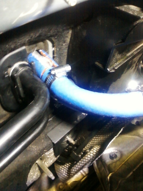

Well I wanted to update this one. I got this done a couple of weeks ago now. I've just been too busy to update it. It's got about 500 miles since I did the job and so far I've had no issues. In my haste I forgot to take pictures of the inside. But I took pictures of what I did on the outside. It looks about the same on the inside. It's just 2 short hoses and 4 clamps. It's real tight with the larger hose inside the box but I made it work. You have to make sure that the clamps on the inside are turned with the worm gear towards the driver side. Or else the ECM wont bolt back in its spot. Maybe I should send these pics to Volvo and tell them I'll take a low 6 figure salary versus a high 6 figure salary and I can make this stuff last the lifetime of the vehicle! If I would've had more time and the car up in the air. I would've discontinued the twist lock hoses completely instead of just the short extensions that go to the firewall and hook up. At least if it leaks now it should be contained to the outside which will be much easier to fix. Hopefully this will help someone else with the same problem.

And to be fair, it's not just limited to volvo either. I believe they're building almost all of them that way now. It just pisses me off when I see things on vehicles that are designed to fail. You pay what some of these newer vehicles cost and you expect it to last a long time. I practically begged her to buy a toyota instead. You just don't see very many maintenance issues with some of the asian auto makers. Well, it's done...for now. Hopefully I wont have to raise the hood on it for a while except to change the oil.
