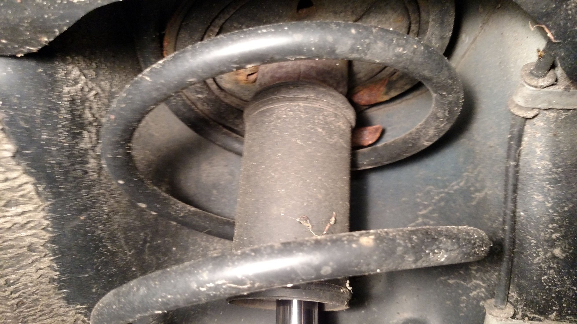

Gen 1 S40s are notorious for having the ends of the springs break. If it happens in the front, it will most likely also damage the bushing/bearing - which btw, is unique to the 2000s - as the design changed for 2001 to 2004. as noted the 2000's strut bushing/bearing is a weak design and can cause the metal/metal contact.
Here's a couple pics showing the difference between the 2000 S40 and the 2001+ Strut bushing/bearing and a pic of a broken coil spring. Note you can upgrade the 2000s to the 2001 design but there are different part numbers for the strut components (including the strut, spring, bushing/seat/bearing ) so you'd need to build a full 2001+ strut.
