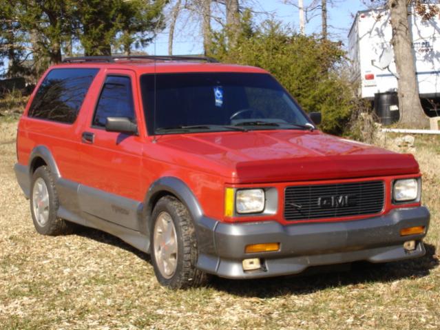

Default Typhoon...FAST !!!!
At the time Road and Track and other cars mags got better times in the 0-60 and 1/4 mile. I have installed a cold air intake and 3 inch exhaust so mine breaths better and is fast than my 2003 porsche Boxster " S " which is about 10 years newer.
I have had mine for about 15 years with 120,000 miles with no major repairs.
