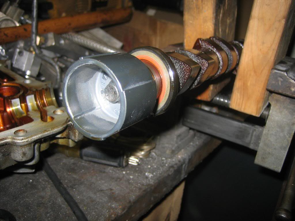

I believe you have to pull the entire cam cover to get to them. Since the cams are under tension from the valve springs and the cam cover is thin aluminum, you have to be very careful that you release the many bolts evenly as to not crack the cam cover. The Haynes manual showed a tool made out of all-thread welded to a hollowed out and threaded spark plug end. I made this tool and used it to keep even pressure across the cam cover as I unbolted it.
The strange thing for me was that I found no gasket or sealant between the cam cover and head. The 4 thin o-rings for the spark plug wells were easy to replace once the cam cover was removed but now you have to decide if you want to use RTV when you put it back together. I did not figuring it might lift the cam cover ever so slightly and affect the clearance for the cams plus it didn't have any from the factory. I did experience oil seepage though. Probably should have used RTV. Oh well.

Thanks Hudini for your input and pics. I just purchased that tool along with cam and crank lock from IPD. Sounds like RTV sealant is a good idea. Have you ever replaced the valve stem seals with out removing the head? Seems to make sense to change them out as i'm right there. Believe all I'll need is an air adapter for the spark plug hole and a spring compressor. Thanks again for your reply!
