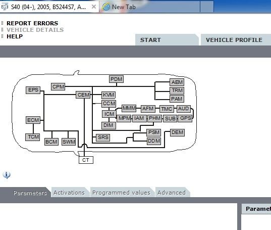

I’m a rookie did not know you could scan your entire car.I just did the OBD scan at autozone and it only brought up ABS. They said it could be my transmission control solenoid but not sure to trust that so I came here to see if anyone else had this happen.
Old May 10, 2022 | 07:37 PM
A compatible scanner will be able to read all of the control units listed in the diagram below if you car has them. (for instance - you may not have a built in GPS or a SUB module - for the subwoofer)
